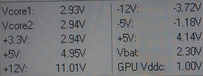

I've recently been cobbling up a faster machine by upgrading my current one (a Dell Inspiron 5676). I've already upgraded from a Ryzen 5 1400 to a Ryzen 5 2600. As a result of this, I noticed that the stock cooler for the R5 2600 wasn't performing well, and I figured it was about time that the system got a front panel fan (yes, it only has one case fan, an exhaust fan). I grabbed a couple of spare fans I have, tried one or two, and a few didn't spin up just because they were old fans.
One fan I plugged in (I guess I plugged it in backwards, hard to tell, I was plugging it via the fan motherboard header) caused the system to turn on for about half a second before it immediately shut off again. I temporarily connected a different PSU to see if I had killed the motherboard, and it seemed to POST okay.
I hooked up a PSU tester to the system's original PSU and it showed that -12v had vanished. When I booted up the computer, the voltages were way out of spec, so I turned it off. The negative rails were nearly gone, with -12v @ -3v, and -5v @ -0.88v. The 12v rail was at roughly 11.4, and so on.
My question is, did I damage both the PSU and the motherboard, or did my PSU sacrifice itself to save the mobo, and I just got away with this by the skin of my teeth? I had zero clue something like this could happen with a fan. I thought it would kill the fan, or the fan simply wouldn't spin up, but no, it blew some of the innards of my PSU all to Hell, apparently.

Reply 5 of 21, by athlon-power
SirNickity wrote:
Does your PSU tester load the supply? It could just be out of spec under a zero-load condition. If it's in-line between the PSU and motherboard, then it should be accurate, and maybe your PSU was just ready to go toward the light.
When I saw those voltages, I was seeing them through SpeedFan while the system was on. The PSU tester was saying that there was no -12v at all- SpeedFan was saying that there was -3v on it.

Reply 6 of 21, by appiah4
athlon-power wrote:
Never trust software voltage readings. Your system would likely not even boot with those voltages.

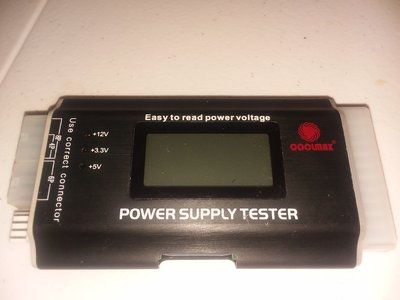

Reply 9 of 21, by athlon-power
SirNickity wrote:
I'm not getting a good visual image of what your PSU tester is or does. Is it just a cheater plug to turn on an ATX supply, or does it do something else?

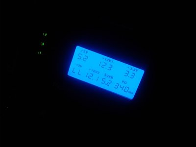

Here's a couple of pictures of it, one of it off and one of it on.
1.01 MiB
967 views
Off
248.52 KiB
967 views
On

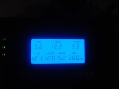

It's still saying there's no -12v. Compare this to when the exact same connectors (1x SATA, 1x 6-Pin, 1x4-Pin, Motherboard connector), are connected to my Corsair TX650W from 2008:

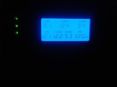

Compare it to this other 300w Dell PSU I have, it doesn't have a 6-Pin connector, but everything else is the same:
430.49 KiB
967 views
On, 300w Dell PSU ca. 2012

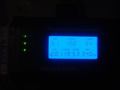

And finally, compare it to this 150w Dell PSU, also without a 6-Pin connector, but everything else is the same:
664.56 KiB
967 views
On, 150w Dell PSU ca. 2005

Reply 10 of 21, by appiah4
That's absolutely bizarre, but the only explanation I can think of is that when connecting the fan you shorted the 12V rail and possibly the transformer at the end of the 12V rail went tits up inside the PSU so now you have no -12V?
