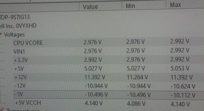

I am now using HWMonitor instead of SpeedFan to get PSU voltages. This is testing with my Corsair 650W PSU from ca. 2008. The only problems here are a weak 12v rail, a weak 3.3v rail, and -10v on both the -5 And -12v rails. I've attatched an image of what HWInfo spits out when the system is under load by Prime 95.
Don't worry about what it says the vcore voltage is, the program itself shows ~1.2v under load in the CPU voltage specific section, the exact same numbers it showed before all of this happened.
1.37 MiB
127 views
Voltages as displayed by HWMonitor under load
These voltages do not appear incorrect (at least, in the same way these do) on the 2008 system or the PSU tester.

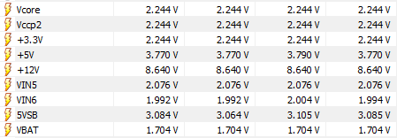

And the voltages SpeedFan gives me at idle:
2.24 KiB
120 views
SpeedFan

These were opened sequentially, but I captured these images within roughly 30 seconds to a minute of each other. If I were experiencing voltage swings that severe, I don't think I'd be typing this out on the very computer I've been discussing right now.
