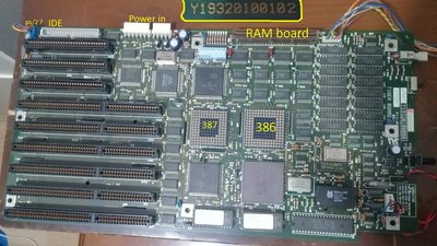

This motherboard is from "epson pc ax3/25" but is very similar (maybe exactly similar) to "epson equity 386/25".
I got it working but there is one problem, it gives this error on start: "161 - System options not set (Run SETUP in REFERENCE DISK)".
Pressing F1 to bypass the error does not help.
Any idea where I can get the image of the reference diskette for this pc ?

Reply 2 of 15, by root42
Yeah, looks like it:
https://pcrebuilding.altervista.org/93/35/MOT … 86+PGA-132.html

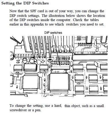

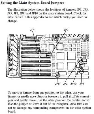

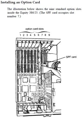

Reply 4 of 15, by PC Hoarder Patrol
Have a look thru the linked user manual
https://www.manualslib.com/manual/301980/epso … ity-386-25.html
board layout and DIP / jumpers seem to be a very close match

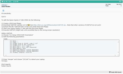

Reply 7 of 15, by PC Hoarder Patrol
Not sure if these are designed for desktops or laptops, but this is a partial quote from user @rubienjo on vcfed
I already found a whole ftp source of reference disks at epsons italian server in the following paths. […]
ftp://ftp.epson.it/pub/es/compu/
ftp://ftp.epson.it/pub/it/pc/
Files with the prefix "rd-" are the so called reference disks for some epson models. Now its the job to find the right one!!!
I see one there call rd-ax325.zip, so that might be worth a try.

Reply 9 of 15, by PC Hoarder Patrol
Did you actually run the SETUP application contained within the zip file at the DOS prompt (I'm not sure SETUP or any of the other reference disk files need to be on a bootable floppy)? Try that and see if it works (may be in Italian by the look of the .VER files).
Another option, from the same vcfed user is to try the generic setup program GSETUP

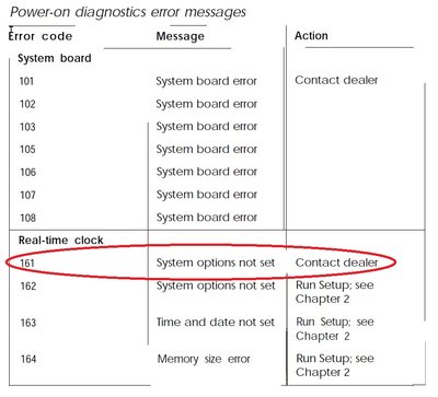

Reply 13 of 15, by PC Hoarder Patrol
That's kind of what I thought, but thanks for the clarification 😀
My next suggestion (for that read stab in the dark!) is a fault / dead battery in the on-board Dallas DS1287 RTC, based on the following,
The Equity 386/25 manual linked earlier mentions config error code 162, but not 161. This is an extract from the Epson Equity 486 manual which does
137.9 KiB
149 views
Replacing the Dallas RTC may solve the problem (is it socketed or soldered directly to the board?)
