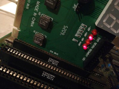

Hi everyone, I have got some trouble with an XT clone and I am seeking for help.
Maybe some of you have a clue what to do ?
Any idea what causes the -12v line to go away the most ?

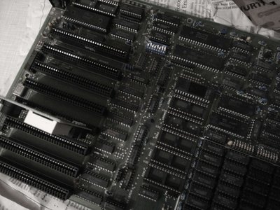

The mainboard is a replica/clone of that popular 8Mhz Turbo clone ("8 MHZ TURBO BOARD").
- There is no POST on the keyboard (works in another XT PC).
- I have checked the power and it seems that the -12 line on ISA has no power.
- I also swapped both the power supply and the 8088 processor against another model.
- I also installed an ISA VGA card (no picture).
Unfortunately, the ISA POST card is of little help. It works in PC/AT class systems only. 🙁
The XT POST codes are simply to old or different to be understood by it.
Any help welcome! ::
PS: I have dumped the BIOS of the board, since I suspected it to be faulty (still not entirely sure).
However, I got readable ASCII signs in a hex editor.. So is this BIOS okay perhaps ? 😕

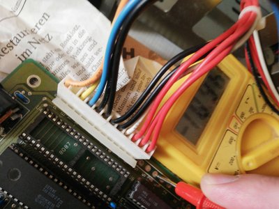

Thank you very much for your reply and the tip! 😀
I' have checked the voltages on what looks like a testing pad..
All voltages are there, so I guess both the contacts and the power supply are fine at least.

Reply 3 of 33, by sf78
You have several tantalum caps on the mainboard, those are notoriously unreliable as they age and don't show any symptoms of failing until they explode to your face. Many XT boards have them and most require replacement by now. Fortunately, they can be measured while still soldered in so it's a quick check and very easy to fix by just cutting the legs of the old one and soldering in a new replacement. Just make sure you orient them the right way around (+ and -).
Reply 4 of 33, by Jo22
I see.. Do I have to check/replace the yellow ones (10µF 15v unipolar ?) only or the blue ones (mainly 0.1µF aka 100nF ?), too ?
And if I have to replace them, can I use electrolytic types instead ?

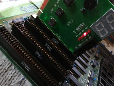

Aw, I already cut one of each's yellow cap's leg. Now the other voltage is gone, too. 🙁

Reply 8 of 33, by Jo22
You are right. 😳 Just checked the ISA bus directly and according to the multimeter, all voltages are there.
Though, I do not know how much current flows through these pins. A real power-consuming component like an LED would be nice.
- The keyboard is also still dead (none of the lights flash during POST). I guess I will need to attach a speaker, as well.
