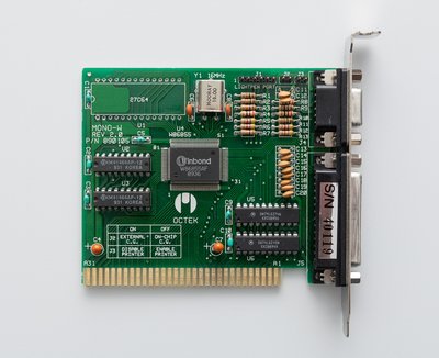

I've recently acquired a second 5151 monitor in a trade. It works fine in text mode but I seem to be experiencing some issues with games.
I've tried with a handful of games, only Test Drive II seems to work so far. The other games give an "out of sync" picture. Which is odd because I thought all these games used Hercules mode, so why does one would work and not the others? I guess it somehow uses a different mode?
I am using this card based on the Winbond W86855AF chipset, which I believe is Hercules compatible.

Reply 3 of 9, by dr.ido
Are sure the various cards are actually outputting an 18.4KHz Hercules signal? I've had VGA cards that were Hercules compatible in that they would display Hercules if you selected it in the software, but they would still be outputting a 31.5KHz VGA signal.
Reply 4 of 9, by Grzyb
Winbond W86855AF is a very common Hercules Graphics Card clone, so yes, it surely outputs typical MDA/HGC 18.4 kHz horizontal, 50 Hz vertical - at least in normal conditions, ie. in BIOS video mode 07h, and normal Hercules 720x348 graphics mode.
Some CGA emulation software may program the CRTC to other frequencies, which indeed can be harmful for IBM 5151.

Reply 8 of 9, by MMaximus
Update - just tested the Winbond card in another machine with my other 5151 monitor. Prince of Persia works correctly as I suspected. So I guess there's a problem with my newly acquired 5151, but I still don't understand why Test Drive 2 would work and Prince of Persia doesn't. Do they use different resolutions? If anyone has an answer to this it would be appreciated!

Reply 9 of 9, by retardware
Timings for graphics modes can be slightly different, depending what the respective application writes into the 46505/6845 registers.
Back in the 1990s I modded a number of HGC clones to feed the Eizo 4051 monochrome monitor to get 90+Hz refresh rate.
There the only thing to do was to accordingly adjust the horizontal scan pot (or was it a coil? don't remember clearly anymore).
If there is no defect in the PSU (see what @SSTV2 wrote - you have an intact monitor to compare with), then you'll have to adjust the LC constant in the monitor. Don't remember now whether the 5151 has adjustment there, if no, then probably adding a small capacitance to the flyback capacitor will fix that.
