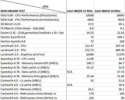

Below are the results with some well known DOS benchmark utilities.
78.8 KiB
645 views
CPU Results
As also noted in other threads, setting the L2 cache to write back, results in quite a performance penalty in terms of memory bandwidth under Speedsys & RAM access (read) time under Cachechk. There is also definitely a slow down in some of the other benchmarks when setting L2 cache to write back.
Both benchmark tests were thus performed with L2 cache set to write thru.
Also of interest, on the Asus VL/I-486SV2GX4 motherboard (which had the 486DX33 MHz CPU installed), both Speedsys & Cachechk wasn't able to "pick up" the L2 cache and therefore unable to perform a benchmark (I tried this with both the 0305 & 0402 BIOS revisions). Speedsys is, however, able to perform a L2 cache benchmark when I set the L2 cache to write back but, as mentioned above, this results in quite a performance penalty in terms of memory bandwidth & RAM access (read) time.
At this point, I'm not sure whether this is a hardware error with the motherboard (could simply be a faulty cache RAM chip). It could also be that I have to install dual bank cache memory on this motherboard and test the results again. I also happen to have another Asus motherboard which I can test this with again but, compared to the results of the Ultimate 486 Benchmark, my results seems to be more or less on par.

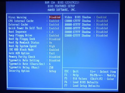

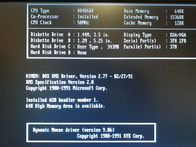

Below are some pictures of my CMOS setup and the best settings I could achieve to ensure a stable setup (under DOS) for my 486DX 50 MHz. With the 486DX 33 MHz, I was able to set everything to the fastest settings and shortest wait states but, still keeping Local Bus Ready at "Synchronize".

Thanks for sharing your results.
The DX-50 might be competitive against DX-33 in early an ISA/EISA system with no VLB card issues. But when compared in a VLB system against much less problematic DX2-66 or even DX2-50 I think it is not worth of the hassle. DX2-66 easily beats it and the DX2-50 is almost as fast in many tests. Especially when opting for DX-50 often means having to increase wait states on local bus and/or moving HDD controller to ISA instead of VL-BUS (since having more than one VL-BUS card on 50 MHz FSB is almost impossible).
