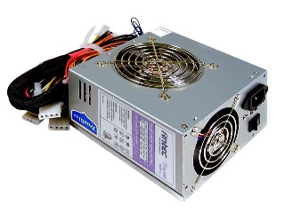

Hello
Antec performance 480w True PSU mfg.2003-2004.
Serial= D03033672855
I have dumped a lot of old PSUs...because not wanting them to destroy my components.
I know a lot of these Antecs were bad PSUs and cause trouble but it is so nice looking with dual fans and gold finger guards. Also I believe someone wants period correct PSUs.
What to do with it ?
Change internals and keep the casing ?
I only use the high-end BeQuiet! and Seasonic PSUs.

I usually don't bother with period correct from '00 onward when it comes to PSU's. I buy newer models from flea markets and recycling for 5-10e and use those instead. That way you can pick a better model and they all pretty much cost the same and have more than enough power to run any old hardware combination. Just make sure to check out the caps and replace if needed.

Mmm, that period correct ripple, noise, vdrop and inefficiency. I can't speak for this specific model of PSU but I had 4 out of 4 Antec (2 were RMA replacements) PSUs fail within their first 12 months of use on models not much newer than that. One of the reasons I did a lot of research and also came up with Seasonic as my go to brand.
Burn it with fire?
Screw period correct; I wanted a faster system back then. I choose no dropped frames, super fast loading, fully compatible and quiet operation.

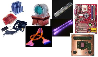

Awww. All old PSUs seems to be bad.
I like 2000-2006 socket A period because of all the fancy tuning stuff.
- Many nice heat sink coolers, leds, cold cathode lights, case windows, UV-round cables, different motherboard colors.

All this fear of (good) older power supplies is highly exaggerated IMO, assuming you are up to the task of doing some basic refurbishing, namely recapping and swapping the fan if it has wear.
The design of those Antec PSUs is very good for the time, it's just that the manufacturing company (CWT) used awful capacitors to cut costs, replace those and they're perfectly fine. They have been using Seasonic/Delta-made units for a while if I'm not mistaken.
And modern (generally black) power supplies stick like a sore thumb in a retro rig.

If you have a use for it, then replace ALL the capacitors and as long as it hasn't already burnt itself out due to it's bad capacitors, it is a good supply.
I have successfully recapped a 380w, and while it was a lot of work, it came out pretty well.
