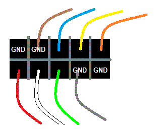

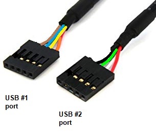

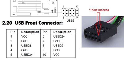

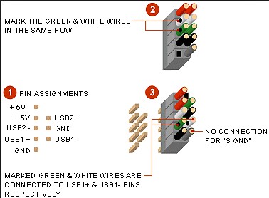

Hello ( 1999 Socket A motherboard )
Case's USB front connector only has 8/10 female connectors and motherboard has all 10 male pins.
- Also one pin hole is blocked in the modern PC case's connector so it won't fit.
- Socket A connector has all 10/10 pins.
Does this mean that I won't be able to use the front USBs ?
Thanks

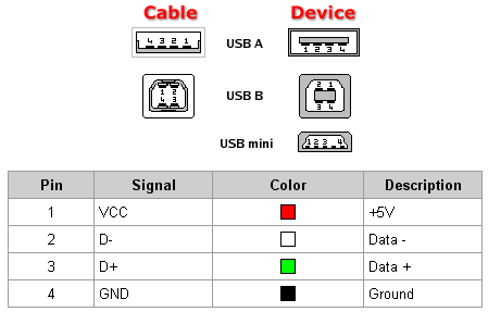

Reply 1 of 8, by Intel486dx33
Get a paper clip and push out the plugs in your USB connector. If your USB connector cable is too short then get and extension cable.
USB Color code
vcc / 5v = red
Ground = black
white = -data
green = +data
Keep the wires separate for USB1 and USB2.
Don't get you wires crossed between ports.

What color goes to what pin # ?
- I'm not that smart.

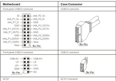

Reply 3 of 8, by Intel486dx33
Pins No-pin and NC are not needed.
if pin #1 is the blocked pin. Then the row behind it is black then green then white and red at the end.
row #1 = Not needed / omit
row #2 ground - black
row #3 +data - green
row #4 -data - white
row #5 - red - vcc / 5v.
Look at example #2 and AC97.

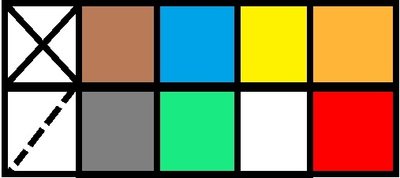

Reply 6 of 8, by user33331
Hello
Tried to think on my own but it didn't turn out OK.
So what color goes to which pin on motherboard ?

Reply 7 of 8, by user33331
No wait. Is it like this. Is this ok ?
What is the name of this 5-pin connector(female) ?

Reply 8 of 8, by PARKE
Those are Dupont plugs, you can find them in every possible size and shape you need for pc's. https://www.amazon.com/slp/dupont-connectors/8q78neyrmxzc6x5
Your last gif shows the right positioning for the mobo in your first post. My advice would be to use a double row 2x5-pin plug. If you plug in a single row pin the wrong way you may burn wires or worse.
