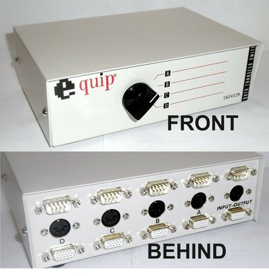

I am intrigued... I have two retro pcs (486 and MMX200) and I would like to interface with both of them through just one mouse/monitor/keyboard.
This switchbox off Ebay seems to be able to do the trick.
243.57 KiB
358 views
I just seemingly need to get two sets of pass-through cables for VGA (M-M), 5 pin DIN (M-M) and serial (F-F) for each PC...
Seems quite simple, am I missing something? Apart from possible degradation of VGA signal....

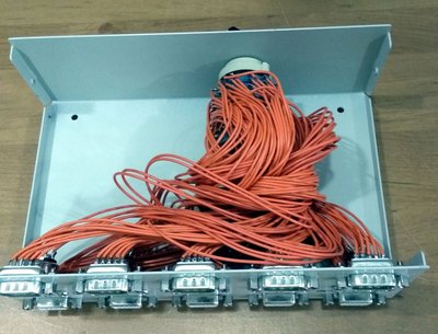

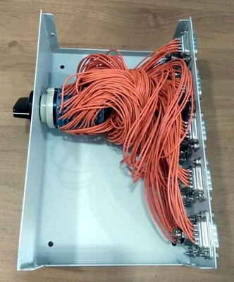

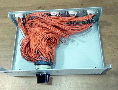

Reply 1 of 12, by assasincz
The seller kindy sent me some pictures of the switchbox internals, looks kinda scary,
What do you guys think?

Reply 2 of 12, by Tiido
This is definitely gonna mess with video signal quality but most importantly it also messes with keyboard and keyboard controller since in disconnects them at any random points. You may get weird issues when switching from one device to the other as far as keyboard goes. Any typematic settings will reset, all the lock settings reset, and mouse will also reset to default state on each switch.
Better things use a little MCU in them that keeps track of what settings are sent to the connected devices and keep them alive for each input.

Reply 5 of 12, by SirNickity
It's a dumb switch, so if you make a break-out adapter for the DB-9, you could probably re-purpose some pins for audio switching too.
Side note, egad the inside of that looks like a still from one of the Parasite Eve cut-scenes.

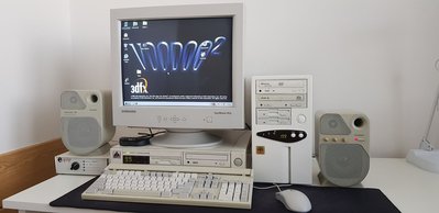

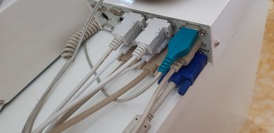

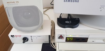

An update (and also a report),
I got finally all the parts I have ordered for for the switch, including of course the switch itself, and proceeded with some testing - here are my findings:
Regarding video quality - as predicted, the quality of the video signal is somewhat degraded (Smearing, ghosts). I find that it is highly depentent on output resolution and refresh rate, as well as on the monitor itself.
As I ordered two VGA cables (1m and 0.5m), I find that the cable lenghts do not play any role. The VGA cables themselves however are quite thin, no ferrite cores, and presumably poorly shielded.
When switched to my Apex 486 running Win95 at 640x480 256 colours (Spea V7 Mirage ISA 2MB card), I do not notice any degradation of the image at all on either CRT (AOC Spectrum 9Glr and Samsung Syncmaster 957p).
The situation is worse when switched to my Oakmont 200MMX (Diamond Fire GL 100 Pro passed through Voodoo 2 card) - It is worse the higher the refresh rate. Output resolution and color depth do not matter. I find that it is 'almost' unnoticeable at 800x600 24bit and 70hz. I will however be getting better sheilded VGA cables to see how things improve, I think there is some wiggle room.
DIN keyboard and serial interface for mouse work perfect no trouble at all. Same with the audio switch.
What surprised me the most is that I can actually switch between the two computers on-the-fly, when both are running - it works great, but I suspect the behavior could be highly dependent on the HW configuration of the computers themselves. As luck would probably have it, my two PCs allow switching between then on-the-fly, without any error in mouse or keyboard inputs. Here is a link to a VIDEOI made showing how nicely it transitions between the two PCs.
I placed the switch box under one of the speakers - I observe no trouble with further degradation fo video quality near the speaker magnet. What is the least pleasing is the resulting cable clutter, but that is to be expected.
119.04 KiB
170 views
253.86 KiB
170 views
206.45 KiB
170 views
200.9 KiB
170 views
Overall - I am quite happy with the switch and how it works. I think it makes for a nice addition to the two-PC setup, making it nicely compact and convenient. I am also glad that I am able to switch between my two particular PCs on-the-fly without any keyboard/mouse communications errors.
