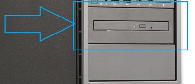

Something like some HP desktops have see photo.
Do Chinese sell these on ebay or are they rare ?
If I find a tray how to connect these the HP's GUD1N: 2.5" sata connectors seem different and smaller than basic 3.5" sata connectors ?
Is the power cable different and data cable same ?
Probably still those same sata to IDE adapters work.

From my experience with these drives in a recent dell server, the sata data connector is standard, the power connector is a shorter version which only carries 5v and ground.
https://en.wikipedia.org/wiki/Serial_ATA#Power_connectors
It appears to just be called "slimline sata".
Not sure on the adaptor, only thing i've seen is a housing which takes a slimline optical and a hotswap hard drive. Maybe try thingiverse?

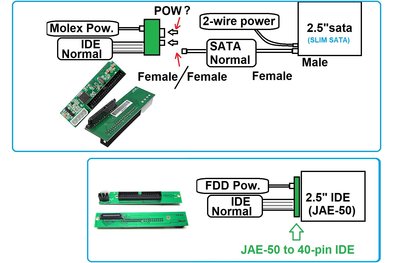

SLIM SATA -> IDE 40 adapters seem also rare...
SLIM IDE(=JAE-50) -> IDE 40 adapters are plenty and cheap.
Hmmm. why is that ? Pretty much forced to use old SLIM IDE laptop drives.
Reply 6 of 6, by user33331
Hello
Can you draw a connection photo for SLIM SATA to basic IDE 40-pin ?
- So SATA to IDE adapter does not need to be powered ?
Thanks
