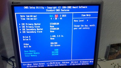

I have this weird problem.
I installed XP on an IDE hard drive on a QDI Advance 10T motherboard
After instrallation, if I have just that Hard Drive attached as Primary Master (Or the Hard Drive plus a CDROM) then XP boots no problem and the HDD is C: as normal in windows XP

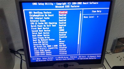

But as soon as I add another HDD as a Secondary Master or Slave (CDROM disconnected) the PC always boots from that drive instead, even though DIsk 1 is the only HDD option set in the BIOS boot
I tried that with a second HDD that has Windows 98 on it and also another one that has a bad copy of XP on it (sticks in boot-reset loop). The PC always insists on booting frpm the second drive.
I then added a non bootable drive as a slave and found the PC will not boot at all, after the POST screen it goes to a blank black screen and doesn't come back.
Also there is a BIOS option that says 'Boot Other Device'. If I disable that the PC will not boot from the XP hard drive at all even if it is the only drive on the system
See pics.
So what is going on??? 😕

Reply 1 of 2, by dicky96
No - ignore all that
Stupid me - I sussed it. I thought it was odd there was no HDD-0 boot option available but there was, further up the list
It's odd though that the PC will boot from a single drive even when HDD-0 is not in the boot device list but HDD-1 is.
Reply 2 of 2, by PcBytes
HDD-0 is the primary disk and HDD-1 is the secondary disk.
Depending on your boot settings, it CAN boot from only one disk, depending on which one you select.
