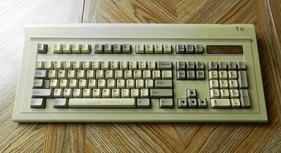

A while ago I got a stack of basket-case mechanical keyboards that I've been restoring. This one is a Datacomp DFK-555 or maybe 86-43 according to the PCB. I can't seem to find a schmatic or a good photo of the inside of one of these online. Does anyone have one & want to pop it open, or can help me answer some questions?
213.62 KiB
92 views

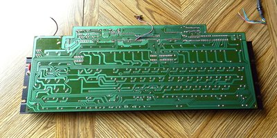

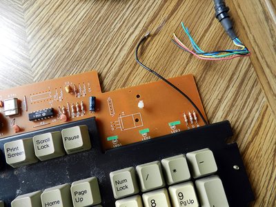

For starters, I need to re-attach the cable. I have what I 95% believe is the original cable, but I don't know the pinout for the header on the board itself. The pins are just labelled 1-5 and the wires in the cable are color coded. There's also a ground wire that's not part of the cable, that was cut:
318.88 KiB
92 views

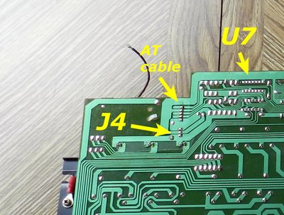

There might also be some missing components. On the back, U7 doesn't look like there was ever anything soldered there, but it does look like there was a voltage regulator removed at J4.
348.78 KiB
92 views
There are a few empty spots on the other side, too (R12, R13, and a spot for a piezo buzzer), but like U7 it doesn't look like the solder pads were ever used.

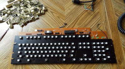

Here's the innards from the front & rear, if it helps:
308.41 KiB
92 views
614.7 KiB
92 views
