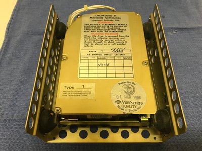

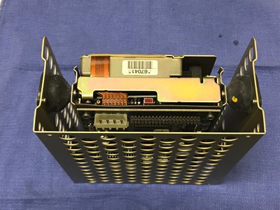

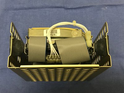

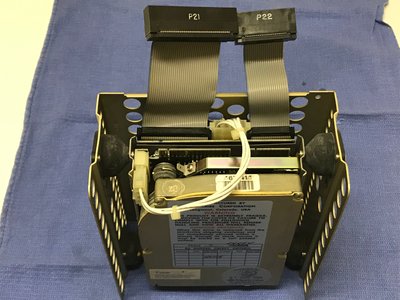

I have recently acquired two Miniscribe model 8212 Type 1 hard disk drives. These are MFM drives - certainly old, but nothing particularly noteworthy about them, I suppose. What made these interesting (to me, at least) is that they are MFM drives mated to a bridge board that converts the interface to IDE! The drives have Compaq logos on them and appear to be meant for the Compaq Portable II. I found this write up while searching for info: https://buildingtents.com/2017/01/01/restorin … aq-portable-ii/.
I am in the early stages of testing them with a generic 386 motherboard and IDE controller. The first drive had a stuck spindle, but a few quick twists got it moving (I haven't tried the second drive yet). I was able to fdisk and format, but got about half the drive as bad sectors. SpinRite and SpeedStor refused to touch the drive. I think I may have had the drive geometry wrong in BIOS though - I'll update this post as the situation evolves.
I am curious: If I were to transfer the drive to standard MFM controller (which would involve a low level format), I suspect I would no longer be able to use it with the MFM to IDE bridge unless that board could perform its own low level format?

Reply 1 of 2, by derSammler
There's no real difference between "MFM" and IDE. IDE just means that the electronics from an MFM controller is part of the hard disk. The IDE host adapter itself is just a buffered connection to the ISA bus.
As for MFM drives in general: yes, they only work with the controller they were low-level formatted with. If you change the controller, you need to re-format the drive.
Reply 2 of 2, by dr.ido
