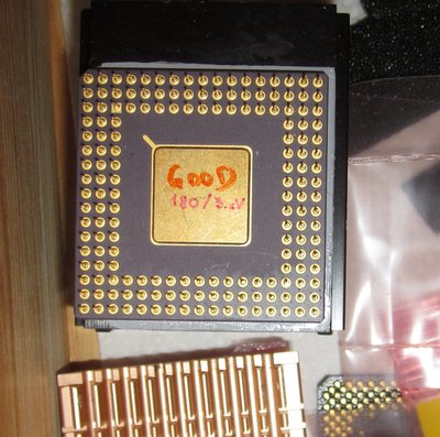

I didn't need to find much as I was not aware that there's a possibility of having the chip run so high. The chip came with some other pentium processors I purchased on an ebay "alternative".
I had an iDX50 running at 60- and 66mhz front side bus(LS486E/C1) and I popped in the AMD, "correctly" lowered the voltage to something like 3.7V<+/-0.25V>(which I did to ensure booting at 150 was 100% possible) but... I forgot to jumper down to 50mhz and was shocked that I saw it booting at 180 and 198mhz respectively. 198 would make it into speedsys but crashed after a few seconds - no matter which voltage.
180 on the other hand worked so swell that I began downregulating the voltage(via potentiometer) to finally end up at around 3.6V.
I will get out the board again(once I feel better) and retest this all and post some screenshots + have it running in windows for a day and document the findings(+removing the heatsink & determining the date code). Please note that I already have used WinTune98 and winquake on the 180mhz chip and it did work for hours without a crash at 3.6V in Win98(32mb ram/no cache).
