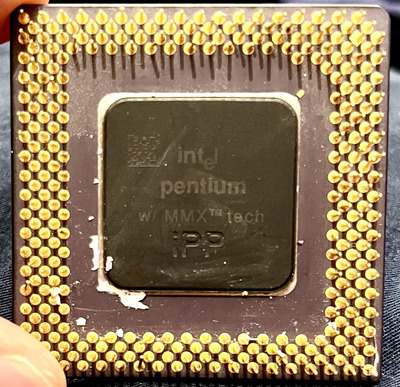

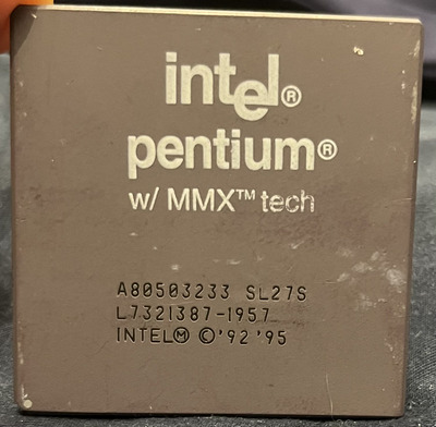

I’m new here but loving hardware since decades. I’m taking the liberty of digging up this topic as I came accross what’s seems to be a Pentium 233 MMX in a CPGA package (ceramic, then, not plastic PPGA) but its sSpec is SL27S which relates to a classical PPGA P233 MMX. Also, I don’t find any mention of any CPGA P233 MMX anywhere else.
I haven’t tried to scratch it to see if it could be a relabelled P200 MMX (or even a P166 MMX) but the engraved numbers and printed labels seem pretty legit so far. What do you think? I also enclose the bottom of the chip, which printed stuff looks rather faded out.
Thanks for your advice on this!

Oh that is interesting
I also have a curiosity, a 200mhz sl27s ppga

So same sSpec ID but different speed. I tend to think that the SL27S speed is 233 MHz, as per the various websites referencing it. Is yours labelled as 200 MHz or is running at 200 MHz (and could run faster)?

labeled, I should check to see if it has the 3.5 X option enabled I suspected it probably does, though maybe not.

For one the front-side dark engraved copyright symbol is odd. The ends of the letter "c" in the circle do not meet close enough.
Fortunately, Asian counterfeiters tend to lack feeling for latin typography details.
Reply 18 of 31, by Sphere478
The marks on a ceramic are laser, if you look at it under a micro scope it becomes obvious very fast if it is melted ceramic or paint
Sphere's PCB projects.
Reply 19 of 31, by pentiumspeed
Fake. The way the laser burnt looks wrong and the copyright symbol is too comical.
Give it a scrape with sharp knife, the top layer should come off. I have a remarked Pentium 150 as 166 like this.
