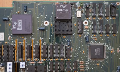

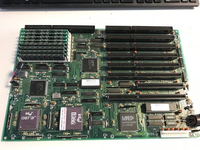

Hi,
I like to install a co-processor on my 386 board:
1.74 MiB
663 views
However, for a 80387 the socket is too big. Can I install it anyway or is such socket only suitable for a Weitek 3167..?
1.75 MiB
663 views
Thanks! 😎
Reply 1 of 18, by jesolo
The socket appears to be a PGA 121 pin socket, which means it's most likely meant for a Weitek FPU. It might not be meant for an 80387DX (or similar) FPU.
Best would be to identify your motherboard here and confirm: https://arvutimuuseum.ee/th99/#1

Reply 3 of 18, by root42
My 386 has a similar socket and sports an Intel 387.

Reply 5 of 18, by Predator99
Hmm, does not seem to work.
With the 387 installed all Sysinfo-Programs (Checkit, Drhard, NSSI) crash at startup...without 387 all are running.
I disabled coprocessor emulation in the BIOS. Maybe some DIP needs to be set? But I dont have documentation for the board.

Reply 7 of 18, by elianda
Most 386 mainboards have an EMC socket, which is the Extended Math Coprocessor socket also suitable for Weitek FPUs. Weitek FPUs have one more pin row around. The sockets also take regular i387.
Also from my experience most 386 boards need a jumper to be set to enable FPU and sometimes a second to set 387 or Weitek.
e.g. look at this: http://retronn.de/imports/hwgal/hw_mb_chips_386.html The board has right of the FPU socket a jumper with 387 ON/OFF and above the socket 3167 ON/OFF which is for Weitek Abacus 3167.
Additionally the BIOS often have an often with NPU disabled/enabled/auto/weitek which has to be set accordingly.

Reply 8 of 18, by Predator99
derSammler wrote:
Funny, I had exactly the same problem when I installed an i287XL in one of my 286 machines. All benchmark tools crashed after that, but the FPU was indeed working. Well, one benchmark tool was still working, though I can't recall which one.
Afaik, only XT class machines needed a dip switch or jumper for the FPU, but you'll never know... Did you try running some software that would not work without an FPU?
I had a problem with DOS/4GW games like Warcraft 2 on this specific board. It crashes with "exception 07h (device not available)". Its related to the FPU according to the information I was able to find.
This message disappears with the 387 installed, therefore it seems to work in some way.
The only diagnostic program that starts up is "Norton Sysinfo" which reports something like "unknown FPU".
EDIT: MSD also reporting 80386/80387 ... seem to be working.

Most motherboards don't have jumper to select the presence of a coprocessor. It is detected by means of software. A few motherboards have jumpers to select coprocessor type (i.e. weitek, 387, 287). Some motherboards have in their CMOS RAM setup option to detect or not to detect the x87 coprocessor during POST. When one is detected a bit flag is set to 1 in the ROM BIOS data area (at 413h if I remember correctly). Most software that uses coprocessor usually detect its presence by using own routines and do not rely on BIOS flag. The Trap 7 fault your dos extender outputs means that EM bit in CR0 register of the CPU is set by some software and no trap 7 handler is currently installed. EM bit is set usually to emulate a numeric coprocessor in software. Some coprocessor emulators do not properly handle warm restarts and leave this flag set. That usually leads to BIOS hangs during warm restarts (depending on BIOS implementation/version and CMOS setup user settings for detection of x87 (if any). If you are considering the usage of a coprocessor emulator I do recommend you Q87/Q387. It handles protected mode software and its performance is comparable to a physical 287.

Reply 16 of 18, by georgel
Early 1990 AMI BIOS...Will analyze it after 10 days. Anyway your dumps are double the size that 27256 EPROMs can hold and that are shown in the picture of your motherboard. Meanwhile if you use Q87 you will solve your trap7 problem for sure and you will have a decent 387 emulation. Probably your BIOS itself provides some crippled 387 emulation, never seen that before.
Reply 18 of 18, by georgel
