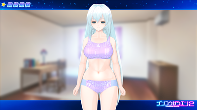

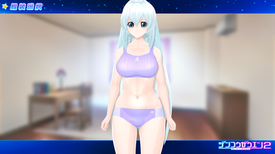

Known Bugs:
-When using user textures for cloth/underware, it causes a large amount of texture distortion depending on the Hue value of the texture that can be set by the game.
normal:
80.62 KiB
10457 views
bugged:
81.54 KiB
10456 views
105 KiB
10456 views
Reply 1 of 6, by Dege
I've merged the special build into main dgVoodoo with the help of a new option.
I also managed to reproduce the texture problem, however, it's interesting: it occurs only on nVidia but works well on my Intel HD Graphics 530.
Also, it's fine through dxvk.
I can't see any problem with the shader that's used for generating the textures. 😖 😕

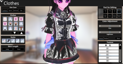

BTW, just to make sure, I used this texture for my debugging:
HW nvidia (artifacts):
WARP (no artifacts):
