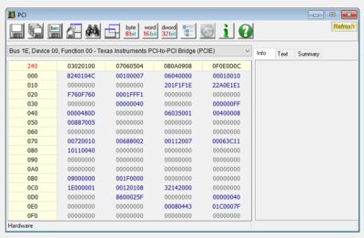

I bought one of these
http://eshop.sintech.cn/pcie-express-x1-to-du … able-p-977.html
with the aim of getting an old YMF744 PCI sound card working on a new system.
It has a Pericom chip on it, and there is a tool to change PCI config registers called PCIEdit
https://www.diodes.com/products/connectivity- … ie-pci-bridges/
however when I try to run PCIEdit with admin privileges my system freezes.
Is there a way to get PCIEdit to work? or otherwise a better tool for changing PCI config registers?

RWEverything is a good program for chaning PCI registers in Windows. But right now I can't get to the program website because my browser thinks it is malicious.

Thanks very much, using RW-Everything I see the config registers.
edit: looking at device and vendor ID reported by windows, it is actually a texas instuments XIO2001 PCI Express-to-PCI Bridge
looking at the documentation
http://www.ti.com/lit/ds/symlink/xio2001.pdf
there is an ISA Enable bit - so I want to make sure I enable the right bit
37.42 KiB
233 views
which bit for ISA Enable?
any hints?
