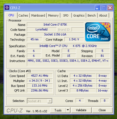

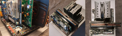

Hardware:
Motherboard: EVGA P55 FTW
CPU: Intel 875k
RAM: 2GB
Slot 1 (PCI-E): Creative Labs X-Fi Titanium Fatal1ty Pro
Slot 2 (PCI-E): Geforce 980 Ti - 6GB EVGA Kingpin
Slot 3 (PCI-E): Geforce 7950 GT - 512MB XFX
Slot 4 (PCI): Voodoo 5500 - 64MB 3dfx PCI Mac
Slot 5 (PCI-E): Geforce PCX 5900 - 128MB ASUS
Slot 6 (PCI): Aureal Vortex 2 (AU8830 B0AAAA 9951-MB213)
Disk: SATA Kingston SSD 480GB
Drive: SATA DVD
Multi-boot Software:
TeraByte BootIt Bare Metal boot manager
TeraByte Image for DOS (GUI) for backups/restores
Partitions:
Windows 98SE #1
Active hardware:
Geforce 7950 GT Extreme edition 512MB
Active software:
Video drivers: Tweaked Unofficial NVIDIA Display Driver 82.69
Audio drivers: Aureal Vortex 2 drivers 2041
DirectX: 8.2
RLoew RAM patch
RLoew SATA patch
RLoew NVSIZE patch
Windows XP 32-bit #1
Active hardware:
Active software:
Video drivers: INF modded NVIDIA Display Driver 355.98
Audio drivers: XFTI_PCDRV_LB_2_17_0008.exe
DirectX: 9.0c

Finally had some time to test the "Geforce 7950 GT Extreme edition 512MB" and it is much better than the Quadro FX 1300. It is a lot faster and at the same time a lot more compatible (cannot stress this enough).
The modded drivers (http://www.mdgx.com/files/nv8269.php) page says even Geforce 9xxx is supported so I might try one of those at some point in the future as well if I find one for a steal. But I am really liking the GF7 series so far, I would say it was a great purchase for W98. Some games still have problems but in the end its only 10-20% of the total problems I had with the FX 1300. Naturally I do not expect any GPU to handle any game I throw at it but GF7 holds up like a champ compared to FX 1300 so it is a keeper for now.
Unfortunately the large passive cooler makes this single-slot card a dual-slot card in practice - this will be in issue later when I will be adding more cards to the system so I will need to figure out some solution to this.

Wanted to try overclocking of the CPU so I added a pretty beefy air cooler. At the same time I wanted to see how all of the desired components fit. Took a few pics while I was at it:
812.15 KiB
4108 views
It fits all right. But don't try this at home. I do not run all that at once. Not yet anyway. I still need to figure out how the "PCIE disable" feature works on this mobo and should probably go with some custom water cooling as well. That would be the last stage of this build, I am still trying to find the ideal combination of sound cards and graphics cards that I will enjoy using in the long run.
And some quick i7-875K overclocking, went from 2.9GHz to 4.5GHz:
52.99 KiB
4109 views
It is not really stable but it did finish the F.E.A.R. benchmark for example. In the long run I think something like 4.0-4.2GHz should be rock solid, hopefully under 1.4V.
