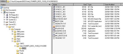

I extracted the contents of BIOS.EXE for the v18 BIOS for the Intel VS440FX motherboard. Screenshot attached. Which file is the BIOS to be programmed into the EEPROM? Is it,
1018CS1_.BIO
1018CS1_.BI1
1018CS1_.BI2
or
BIOSCS1.REC
Each of them are 65K. 1018CS1_.BI3 is 41K, so I assume this is not it.

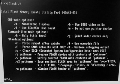

And any chance this BIOS can only be programmed using the iflash.exe program, that is, does iflash do some piece-wise selection or sumation of the various files from BIOS.EXE package?

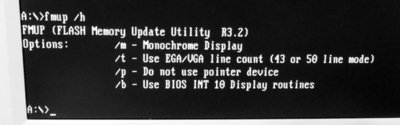

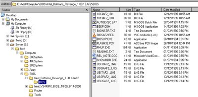

On my Intel Batman's Revenge socket 4 motherboard, when I go to save a BIOS file using the Intel BIOS utility, it saves two separate files:
1010AF2T.BIO at 64.1 KB
and
1010AF2T.BI1 at 48.1 KB
When I use NSSI to make a copy of the BIOS, the file size is 64.0 KB. But when I use the Intel BIOS utility (FMUP.exe) to verify that the NSSI BIOS matches that of what is currently programmed in my EEPROM on this board, I receive an error "The loaded file is not a valid Flash Data File.
Why is that? Is anyone willing to use a program like NSSI or preferably AMI Flash (version that works w/PPRO?) to create a single BIOS file for the Intel VS440FX? Are there programs besides NSSI which will also write the EEPROM chip while in board? It uses an American Megatrends BIOS, perhaps some version of their software?

Oh boy, the faulty BIOS chip is nothing, compared with the obscure BIOS updating practices of Intel. I had downloaded the same BIOS update utility and inspected main files with a HEX editor.
feipoa wrote:
Which file is the BIOS to be programmed into the EEPROM? Is it, […]
1018CS1_.BIO
1018CS1_.BI1
1018CS1_.BI2
or
BIOSCS1.REC
None of the above, the BIOS image is divided into 4 parts, starting with *.BIO and ending with *.BI3. Each part has a 128 byte long header, which can be read with "SHOWHDR.EXE" program.
Definitely, at least as long as boot block is intact and not corrupted, you could just insert the floppy disk with recovery files and after boot-up, BIOS recovery would then start automatically (there usually is a BIOS recovery JMP/SW somewhere on a Intel MB for that matter).

64.0KB file definitely did not have a header when it was written with the help of NSSI, that's why "FMUP" could not recognise it. It's also possible that the whole BIOS image is compressed, because there is basically no legible ASCII text when *.BIx images are read with a HEX editor (in 440FX MB BIOS case). If that's the case, then you'd be comparing some random 64K data of decompressed BIOS image with an original 64.1K image, besides, shouldn't Intel S4 MB have a 128KB BIOS image?
According to "SHOWHDR.EXE" the lenght of all *.BIx files is 3A000 HEX, which translates to 237568 DEC (232KB), 24KB is missing to fill the whole chip, so I guess boot block is not included into *.BIx files, but... "1018CS1_.RCV" file is exactly 16KB long, which probably means that it's a boot block image. Not sure where the rest of 8KB should be, maybe BIOS update utility automatically fills those missing bytes with FF's on update?
Either way, if 16KB file is actually a boot block image, then you are saved 😀

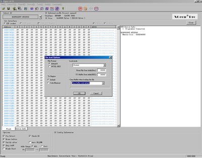

The EEPROM chips I have on order are E28F002BV at 60ns. And because of logistics, I did end up ordering the TL866II plus, which came with all the adapters pre-packaged. So, the new programmer arrived today. The TL866II plus has specific support for the E28F002BV, but not the *BC for some reason. Hmm... Are you familiar with this programmer? It came with some 25 adapters. I essentially bet the farm on getting this damn board working rather than sourcing a new one. https://www.ebay.com/itm/223265765989 According to the seller, for E28F002BC, I would use TSOP32/40/48 adapter with TSOP40A adapter, then put it into the programmer. The programmer arrived today, but the E28F002BV chips have not. They are from China utsource.net The Micron chips, MT28F002C1, have arrived at my US-shipping service location, but I'm not ready to ship all my junk up to Canada just yet.
I installed the TL866II software, but it doesn't let me use it if it doesn't detect the hardware attached to the USB port.
I've sent TL866II a tech support question about burning these multi-parted BIOSes, but I don't anticipate much help there.

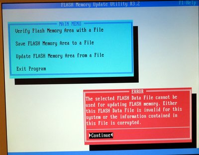

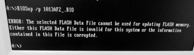

For the Batman's Revenge Recovery disk, I went through the process of creating the Recovery Disk, which intel has some DOS software that creates the disk with the relevant files on it.
65.09 KiB
2014 views
This is a bootable diskette and contains a single binary BIOS file, OLDBIOS.BIN.
This is odd because if you look at the non-recovery disk, but just the ordinary BIOS update disk, the BIOS is broken into parts. For the Batman's Revenge board, see below:
140.51 KiB
2014 views
So the official recovery disk is glueing these BIOS pieces together for us? And if that is the case, would obtain a VS440FX Recovery Disk allow us to write the glued BIOS with the programmer and be done with it?

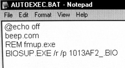

Yes this Gateway motherboard has been upgraded with success. But you have to use the bios recovery method. I got my instructions from this forum some time ago but here they are. You make a bootable disk BIOS disk as per instructions that come with the BIOS file download. After the disk is finished remove the READ ONLY attribute from the AUTOEXEC.BAT file on the disk. Open it up with Notepad or Edit find the line "iflash" and change it to read "iflash /p <filename>.bio" <filename> should be replaced with the file on the disk with the .BIO extension. shut down your computer. Put your motherboard BIOS jumper in recovery mode insert your disk and powerup the machine. YOU WILL HAVE NO VIDEO OUTPUT!! your machine will beep once then run the floppy for SEVERAL MINUTES. Let it run until you hear two beeps wait an additional two minutes. Power off return the jumper to normal position and restart you will now have the intel POST screen and updated BIOS. Good Luck
I wonder if this would work on my Gateway Batman's Revenge board to get 10.13 running rather than 10.10. But perhaps the above scheme doesn't work on this board because the Batman's Revenge BIOS on the Recovery Disk is not pin 2 parts, rather, it is 1 part. And the 10.13 update is in 2 parts.
I don't have that programmer, unfortunately, but if it doesn't support the BC variant of that FLASH chip, then it simply can't supply 12V to the RP# pin.

Here's a screenshot of the TL866IIplus software. Showing instructions of which adapters to use with the E28F002BV chip.
246.4 KiB
1939 views
And the pop-up config page that I receive after trying to import your boot block binary. I left everything at default.

I was considering again the recovery method for updating the BIOS on my Batman's Revenge board as this board was already on my testbed. It contains BIOS 1.00.10.AF2T, the T being OEM for Gateway. I run FMUP.EXE on the BIOS update disk and get the following error:
151.06 KiB
1944 views
For the VS440FX board, autoexec.bat contains iflash /p 1018CS1_.BIO , which should automatically program the BIOS. As I understand it, this is needed because there won't be any display on the monitor to manually select BIOSes. Now the BIOS update disk for the Batman's Revenge doesn't use iflash.exe, it uses fmup.exe. And when I compare the command flags of iflash to that of fmup, I see:
190.53 KiB
1944 views
43.47 KiB
1944 views
/p has a different function in fmup and it doesn't look like there is a program flag for fmup like there is for iflash. My questions are then a) can I use iflash.exe for the older Batman's Revenge board, and if not, then b) since there is no monitor output in recovery mode, would I need to practice the exact sequence of keystrokes with fmup.exe to go through fmup's GUI to get 1013AF2_.BIO programmed once the system has booted in recovery mode? e.g. once floppy activity ceases, <Press Enter>, then <Press down arrow twice, followed by Enter; this gets you into "Update FLASH Memory Area from a File">, then <Press Enter; Update System BIOS>, wait for diskette access, then type in <A:\1013AF2_.BIO>, followed by <Enter>, wait for diskette access to cease, then <Press Enter; Continue with programming> After this point, I'm not sure what to do because in the test drive, I get the above error (first photo shown with red highlight).
Or perhaps simply editing the autoexec.bat file with FMUP.exe A:\1013AF2_.BIO ?
According to the release notes, BIOS v.13 has the following advantages over .10. With the current BIOS and hardware, I am unable to get the RZ1000 PCI IDE chip to work with a CD-ROM drive in either DOS or Windows. Perhaps this has been addressed since v.12, and I am using the Pentium Overdrive 133, so it would be nice to have proper freq. display.

Recovery method for a working motherboard? Why? Were you trying to flash the one part/two part images or both? What do you get when using "BIOSUP.EXE"?
Well, on the Batman's Revenge official recovery disk, it creates a single BIOS image, but it is only revsion 8. So that's of no use... Unless it forces the BIOS to be an official Intel one (non-Gateway OEM), and after such, I can program the .13 official latest Intel BIOS. That's an idea I just thought of. But what I was hoping to do was update my Gateway branded Batman's Revenge board with .10 BIOS to that of Intel .13. It was shown, at least for the VS440FX board, that you can use the recovery method to change the Gateway OEM BIOS to that of Intel for upgrading purposes: Updating BIOS on a Gateway 2000 VS440FX motherboard
So I was hoping to use the recovery mode with the two part Intel v.13 BIOS, but not sure which flash updating software will work with both this motherboard/chipset and the two part Intel BIOS. To go from Gateway to Intel, it must be in recovery mode. I'll try using BIOSUP.EXE from the v.13 Intel BIOS software disk and see what happens.
I think FMUP failed to recognise the image because my current BIOS is from Gateway, and FMUP was trying to use an Intel BIOS. From the exampled in the above linked thread, in going from Gateway to Intel BIOSes, it was done and worked in recovery mode, but not in standard mode.

Here are the startup options for BIOSUP.EXE . It even has /r to automatically reset the system when finished updating.
35.2 KiB
1892 views
60.85 KiB
1892 views
This is the error I get when using BIOSUP.EXE to update the .10 Gateway version to my the .13 Intel version. I with the error was more deterministic, but to me is sounds like it won't update because it doesn't want to let you run Intel BIOSes onto Gateway ones. But apparently recovery mode allows for this.
53.56 KiB
1892 views
I'm at the point now of: to try it, or not to try it. Am I feeling lucky today? The boards on the testbed now, and it won't be on Monday when the EEPROM's come for the VS440FX board.
