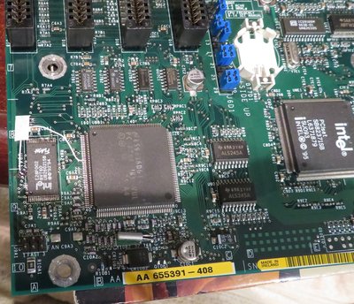

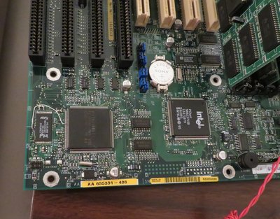

Reply 40 of 80, by feipoa
Reply from TL866IIplus distributor:
TL866II can support VPP 18V and VCC 1.8V-6.5V, You don't have to worry about 12 volts. You can test it yourself with a blank chip.if it can not work,Please send me the screenshot of the error message,I'll report your problem to the manufacturer
He doesn't seem to understand that I'm wanting to know about 12 V to RP#, not Vpp. Perhaps my question wasn't clear enough, his English isn't good enough, the automated eBay English to Chinese translation isn't sufficient, or his knowledge is too limited. My message to him was:
Intel E28F002BC and Micron MT28F002C1 both require that 12 V be passed to the RP# pin to unlock the boot block.  Is the TL866IIplus able to supply 12 V to RP# to unlock the boot block?  If not, the TL866IIplus cannot properly program these EEPROM chips.  On the other hand, Intel E28F002BV and Micron MT28F002B1 chips (which are on the TL866IIplus support list) do not require 12 V to RP#. These EEPROMs can unlock the boot block with only 5 V to RP#.  Please confirm if TL866IIplus can supply 12 V to RP# on the TSOP40 pinout (E28F002BC and MT28F002C1)?

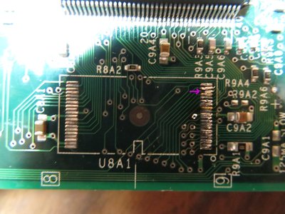

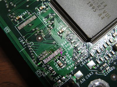

You should also inspect Vpp and RP# pads on motherboard, maybe they constantly receive 12V.
At least in the off-state, Vpp and RP# do not receive 12 V. No other pad on the TSOP40A received 12 V.

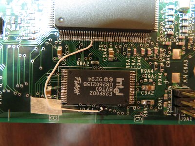

Reply 47 of 80, by feipoa

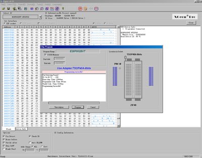

1) write the bootblock bin you attached to E28F002BVT60 using TL866IIplus using TSOP40A adapter
2) solder E28F002BVT60 to motherboard
3) set recovery jumper on VS440FX and power on
4) ensure that the 1.00.18 recovery diskette is inserted
5) wait until no more diskette activity, wait 2 more minutes, power down, put recovery jumper back to normal, reboot
6) voila?
Or is there any benefit to powering up the system without the recovery jumper set once the EEPROM is soldered on? Perhaps the power LED will stop flashing?
Reply 48 of 80, by feipoa
Wait a minute... I measured Vpp in the off-state again today and it is connected to 12 V. RP# is not connected to 12 V, nor 5 V. Either I was mistaken the last time I measured Vpp, or there is an intermittent short. Does this new found knowledge alter the next course of action?
EDIT: power-on test, Vpp is 12.33 V. I went to measure RP# and the board (or power supply) started making a hissing sound, then the system shut down. I unplugged everything, waited 5 minutes, plugged the PSU back and hit power, the CPU fan spun up, but after a few seconds, there was this hissing sound. I thought it was the CPU fan, so I unplugged it, but the hissing sound was still there. It got louder, and fearing that I might get a cap blown in my face, I turned it off. Again, I'm not sure if it is the PSU, or the MB, but considering the issues, I'm guessing the MB. I checked for shorts on those electrolytic surface mount caps, but didn't find any shorts.
EDIT2: The capacitor just below the CPU socket measures only 30 ohms across its terminals. I'm guessing this is the source of the hiss? Perhaps I'll remove the cap and measure the resistance on the solder pads... EDIT3: the solder pads without the cap are also 30 ohms. EDIT4: swapped the PSU, don't hear a hiss so far. I'm going to let it run for a few minutes. Still not sure what to do about 12 V on Vpp. Perhaps a default response when no BIOS detected? EDIT5: I followed the traces for Vpp and it is intentionally hard-wired direct to 12 V, and not through a pull-up resistor. I guess I will continue with programming the *BV chip now.
EDIT6: Another user with the board also confirms 30 ohms across the resistor I removed and that Vpp on the EEPROM is wired to 12 V.

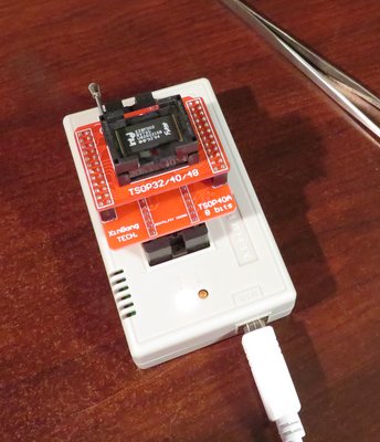

Reply 49 of 80, by feipoa

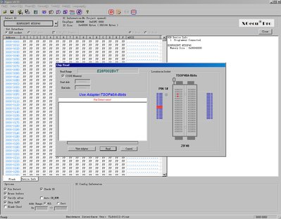

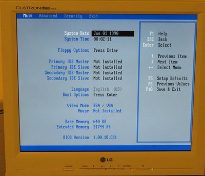

Here's the programmer with the double adapter sandwitch.
420.94 KiB
1713 views

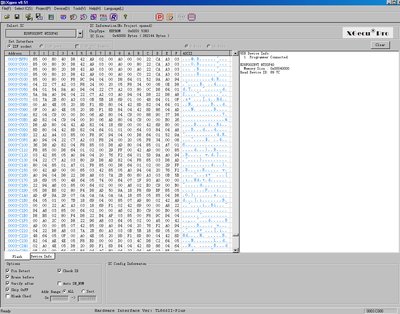

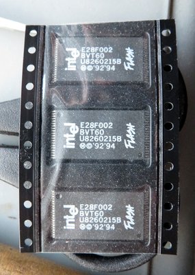

I decided to read what was on the NOS E28F002BVT60. They don't come blanked?
517.17 KiB
1713 views
I decided to save the code that came on the unprogrammed E28F002BVT60
E28F002BVT60_insert_to_programmer_and_read_then_save.zip
89.54 KiB
79 downloads
SSTV2's code imported. It put FF's on all other locations.
521.24 KiB
1713 views
Programming successful.
423.62 KiB
1713 views

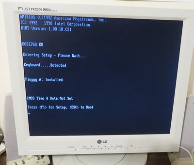

Reply 50 of 80, by Sedrosken
That's almost intimidating...
Excellent! Here's hoping you get it to POST first-try. I also hope that's the only issue you'll have with your board.

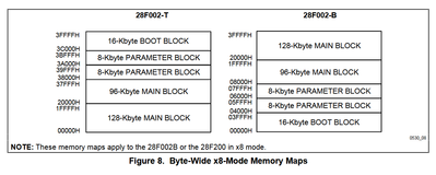

Looks like flashing the motherboard never changes the boot block. This is part of its protection mechanism. But makes me wonder, though, why does Intel update the boot block code between revisions if it doesn't get implemented? Must only be for new motherboards being pushed out. Intel must have some software/programmer combination which combines their BIOS fragments before writing the EEPROM.

I have soldered on the boot block programmed E28F002BV EEPROM. Unfortunately, I ripped off part of the pin (arrow in photos) and had to run an external patch wire. I don't have much experience soldering on such tight spacing - perhaps my smallest tip isn't quite small enough, so I had some issues with solder blobs. Using a spring loaded, hand held solder socker simply provides too much kickback and uplifted a few pads. I was able to get them back in place, but one of the pads broke of half-way.
Nonetheless, the best approach to get this IC back on was to pre-coat all the pins with a just the right amount of solder, then align and hold the EEPROM in place with masking tape. Then bring the soldering iron to each pin and let it reflow onto the EEPROM pins. On my first attempt, I didn't have any solder on the TSOP40 pads and tried to add solder to each pin as I went a long. After about 8 chips in, I started getting fat solder bridges, and this is when I brought out the spring-loaded solder sucker (ooops!).
Anyway, I'll try to fire this up tomorrow. I assume I'm to go right into recovery mode?

EDIT: If I get it working, I'll probably take the tape off and tack the wire down with a dab of epoxy. Also, I had to use these 10x magnifier glasses to solder the TSOP40 leads. I noticed only one burn scab on my nose this morning, though I swear I burned myself twice.

Success!
I was really skeptical when I powered it up in recovery mode because there was no diskette activity for about 40 seconds. I was about to turn it off, then all of a sudden the diskette started reading. Once diskette activity ceased, the diskette light was on solid for what felt like 2 minutes, then it finally went off. I placed the BIOS normal jumper back on, then rebooted. System asked me for a password, so you also must set the disable password jumper, turn on, then off, then on again with the password jumper back to default. I'm attaching some photo proof that it works.
215.51 KiB

I also removed the tape on the jumper wire as the fix looks less obvious this way. I should get some of that green 32 AWG wire that I see some manufactures use on motherboard for fixes. It is really inconspicuous. At least I think it is 32 AWG. The white kynar cladded wire shown in the photos is 30 AWG and the wire on MB fixes I've seen appears smaller.

For the record, I contacted the the eBay distributor about not being able to use the *BC EEPROM on the TL866IIplus programmer - he was in fact the one who claimed the *BC EEPROM was supported prior to purchase. He did get back to me what a somewhat dubious solution, to uncheck "pin detect" and "check ID" on the programmer software. Unfortunately, I do not have a working *BC EEPROM to confirm if this method actually works, but I've attached a screenshot of the result with my faulty *BC EEPROM. Overcurrent protection! External Short!
448.01 KiB
1597 views
