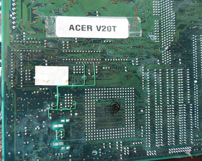

feipoa wrote:
I should get some of that green 32 AWG wire that I see some manufactures use on motherboard for fixes. It is really inconspicuous. At least I think it is 32 AWG. The white kynar cladded wire shown in the photos is 30 AWG and the wire on MB fixes I've seen appears smaller.
That ripped trace/pad can still be restored to the point, that no one would ever tell it was damaged. For that you'd have to desolder the chip again and solder a trace, borrowed from any PCB (the point is, it must be flat), on top of the existing one.
Should look something like this:
I had considered using a strip of copper tape (though cutting off a donar trace might be easier), but was hesitant because of the added complication and possibility that the EEPROM hack would not work. If I was 100% confident that the EEPROM would have worked, I may have put more effort into doing a proper trace repair. These traces are really tiny and tightly packed. Perhaps for someone with steadier hands. Also, isn't there the risk that solder point under the EEPROM would reflow away from its point of contact, toward the heat source which is touching the EEPROM pin during reflow? Is it kosher to place an un-cladded conductor across other traces? Would have to ensure there weren't any scratches. I should mention also that the EEPOM solder pad just to the right of the damaged pad was also damaged and I had to straighten it, so the spacing between those two pads is a lot closer than it is normally (its somewhat arched). I'd also be concerned that the thickness of the trace would be enough to make the EEPROM pins not be in contact with the pads for the reflow to work well on much of that side of the chip. I weighed all this in and went with the an external approach. Its not a rare high-value motherboard by any stretch. I got it for $30.
Speaking of boot block, I wonder what Intel changed in the .18 boot block code for this board? And does the recovery mode replace the previous boot block? I don't recall now which of the 3 boot blocks I put on the EEPROM.
EDIT: Here's some official track patch work done by Acer on a V20T motherboard.
No, if soldering point would be as far as I've marked it, then the trace would not desolder and drift away, while soldering IC, you can also grease it with epoxy and glue in place. The trace can be uninsulated, it won't short with other traces underneath it, the solder mask prevents it.
