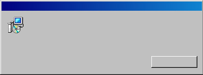

Reply 10 of 18, by feipoa
Alright, I was able to download v6.0 of VirtualBox, tried to isntall, but it says it no longer supports 32-bit installations. I'll try various 5.x versions until I find one that works. I'm currently using an AM2 upgrade card (X2 6400+) on my AsRock 939Dual-SATA2.
I tried 5.2.32, but received this error upon installation
VirtualBox Installer
Installation failed! Error: The WIndows Installer Service could not be accessed.  This can occur if you are running Windows in safe mode, or if the WIndows Installer is not correctly installed.
And the Installer box looks like this, there's an empty button - should I be pressing it?:
14.22 KiB
705 views
I tried 4.0 and 4.3 but receive the same error and a blank installer box. Perhaps the issue is my installer? But I have WindowsXP_WindowsInstaller-v4.5-KB942288-x86.exe installed. Anyway to get VirtualBox installed without the installer? Or perhaps there some other free virtual machine I can try?
Reply 12 of 18, by feipoa
Ok. Unfortunately not pushing it still doesn’t let the program install. Maybe there is a portable version of this program?

Reply 14 of 18, by xjas
VirtualBox 5.x needs some fiddling to get working on Windows XP. I didn't get the 'blank box' error, but I'm betting it's the same one.
You need SP3 with the most recent Windows updates installed (not necessarily POSReady, but those won't hurt) and some fiddling around with Setreg from the dotNET SDK. See the thread I linked for details.
Vbox 4.3.12 might run without all the extra steps, but I haven't tried. What they changed after that was a security hardening, so if you're running it because you're concerned about security, use a newer version.
Also I'd highly recommend enabling VT-x or AMD/v in your BIOS if you have the option, especially if you're going to try browsing from the VM.
Reply 15 of 18, by feipoa
I can't get the software to even install. I suspect something is wrong with my MsiInstaller. Every one hour I get an MsiInstaller Application Warning in the Event Viewer.
Event ID: 1015
Type: Warning
User: NT AUTHORITY\SYSTEM
Description:
Failed to connect to server. Error: 0x80080005
Perhaps it is related to this Event Viewer Applcation error I get on boot from source userenv:
Event: 1502
Type: Error
User: NT AUTHORITY\NETWORK SERVICE
Description:
Windows cannot load the locally stored profile. Possible causes of this error include insufficient security rights or a corrupt local profile. If this problem persists, contact your network administrator.
DETAIL - Access is denied.
Followed by Event 1515: Windows has backed up this user's profile. Windows will automatically try to use the backed up profile the next time this user logs on.
Then followed by Event 1511: Windows cannot find the local profile and is logging you on with a temporary profile. Changes you make to this profile will be lost when you log off.
Then the same trio of errors repeats for the LOCAL SERVICE.
Maybe they are related to the MsiInstaller, maybe they are not. Perhaps some POS update messed up something, or perhaps a system restore brought on the errors after a bad POS update. Both my laptop and desktop have identical error logs.
Reply 16 of 18, by xjas
Sorry, I skimmed your post & misread that. I had no trouble installing it even on a completely fresh XP SP3 machine. Something's going wrong there, but no idea what.
