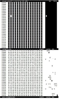

doh! While I have a much cleaner board 😀 it seems my success was short lived. Bet you could have seen that coming 😵
Since my last post I've been trying to get both CDROM and HDD to play nice together on this system, during which I would have rebooted ~100 times with out any sign whatsoever of the glitched HDD model numbers during startup... I was able to boot reliably to CDROM or HDD but only if there was only one attached to the system: trying many many possible combination of jumpers, Primary/Secondary MASTER/SLAVE setups etc with multiple different drives and multiple CD drives and multiple cables, etc. And now.. the glitched names have returned and I can only boot to floppy, so I'm back to square one. 😲
I have noticed that the BIOS is being modified during post (after booting once it's reading back a different image on the tl866 than was written to it), and I'm not sure that's normal? I'll start another topic about that and will post here again if I make any progress with the glitched model number issue, then any further issues with the system.

Tiido wrote:
ESCD is often written into the BIOS chip.
Have you tried to lower the FSB to see if it would make a difference ? Jump from 66 to 60MHz or perhaps 55 can show some improvement and perhaps disabling of cache also. If those have no effect the problem is not related to some timing violation but instead something physical (bad via, connector etc.)
knowing whether this is ESCD is a bit over my head. I've attached the original BIOS file along with the version I get after 1 boot. I've also attached a pic of a hexdiff of the main area of difference. If you know what to look for, please tell me if that looks like ESCD data to you?
I will try lowering the FSB and report back if there is any difference. Thanks for your suggestions!
(for future reference, the BIOS I am currenly using is the one from the file 520_Bios_19981207S_UNI [NP].zip downloaded from http://cwcyrix.duckdns.org/techpage/download/ … 525-stuff/bios/)

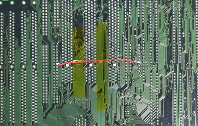

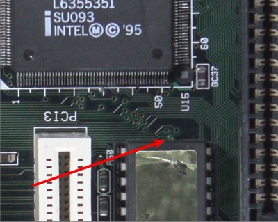

So, I was pretty certain it was something physical with the board. I had ordered one of the IDE testers mentioned above but that was weeks away, so I set about tracing all the IDE connections on the pcb...
I used an IDE pinout diagram (https://pinouts.ru/HD/AtaInternal_pinout.shtml) along with the datasheet for the PCIset SB82371SB chip (http://pdf.datasheetcatalog.com/datasheet_pdf … d_SB82371SB.pdf) to find out which pins the IDE socket was supposed to connect to.
What I found was thhat IDE pin 13 did not have a good connection to the chip and went through a funny looking via.
148 KiB
494 views

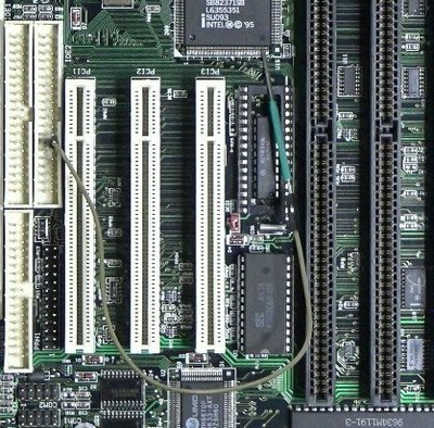

Sure enough that via was the culprit and after I bypassed it with a jumper the board worked as it should.
77.26 KiB
494 views
I then bypassed it permanently by soldering a bodge wire on the underside of the board that would effect the missing connection. I did try to fix the via but it was too small to fix without damaging the board.
427.65 KiB
494 views
I would guess that this board's IDE had been giving problems since leaving the fabricator and that is why the prior owners had used a SCSI controller for the drives. I had read somewhere that PCCHIPS boards are of "sub-par" quality, and perhaps this defect is further evidence of it!

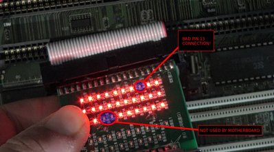

Just a quick follow-up on the IDE slot tester which arrived last week.
I disconnected the wire I had soldered to return the fault to the motherboard and sure enough the tester shows that there is a bad connection on PIN 13.
274.71 KiB
309 views
tester showing bad pin
So it Looks like the tester would have helped to diagnose the issue much faster. Though the tester was in no way required it's reassuring it would have worked!

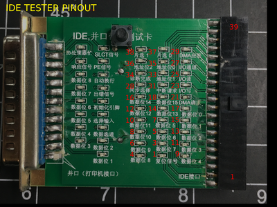

The Chinese written on the tester was a little difficult to interpret so I recorded the IDE tester's pinout in this pic.
1.22 MiB
309 views
ide tester pinout
