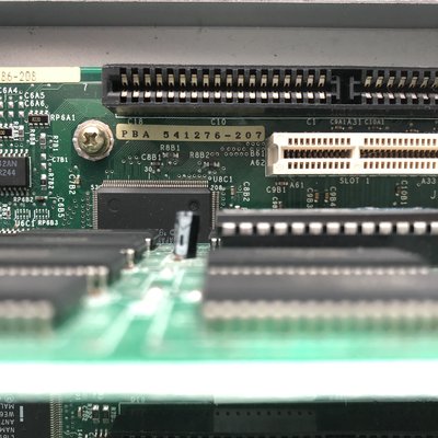

This is interesting. The PBA number on this Plato board is 541277. According to the manual, it will only work with the 75 and 90MHz Pentiums. But when I put in a P100 and set the jumper for 100MHz, it goes into BIOS, shows the correct speed there, and boots from the floppy just fine.
IMO, that fact changes everything, and makes this board worth reviving; worth spending a little time with the dremel fixing the RTC chip. A 100MHz Pentium system is a very useful machine for software of that period. Kind of the archetypal machine for Win 3.1 really, and maybe even 95.
Where do I find a PBA number on a Gateway model?
Does it support 100Mhz CPSs?
The PBA is on a small sticker between the shared ISA/PCI slots. Officially, there is no 75/90 board that supports 100 mhz and vice versa. You just have to try it and see if it works.
edit: Additionally, the PBAs that support the 100mhz CPU will support the 200mhz MMX Overdrive processor. This is specifically because of an upgraded voltage regulator on those boards. I suspect this is probably the difference between the 75/90 and 100 PBAs as well, and even if a 100mhz chip "works" on the lesser board it may be subject to intermittent behavior, overheating, and/or premature failure. Individual results may vary, of course.

I question this. Does a P100 really require that much more power than a P90? I haven't seen the specs, but I doubt it. Certainly not sufficient to cause what you describe.
No.
P75 has 8 watts
P90 has 9 watts
P100 has 10.1 watts
Unlikely that this makes much difference.
However, the 10.1 watts for the P100 is for the ceramic version. The older gold cap variant may need more power.

It doesn't look like much but the P100 at 10.1 watts crosses a 3 amp threshold. The Overdrive upgrade requires 5 amps. You can see where engineering decisions might have been made to satisfy cost requirements.
