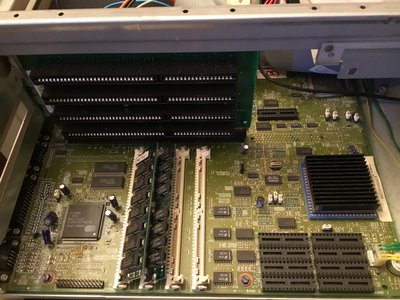

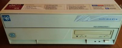

Hi, I have acquired an IBM PS/1 multimedia.desktop computer.
I think this was the first Multimedia computer built by IBM for the home consumer market.
This would have been the pre-built 486 computer I would have liked to have back in 1994.
My 1993 custom 486 mid-tower build was almost this nice.
These IBM PS/1 computers with there IBM software interface menu are the Cadillacs of the 486
Computers for there time.
Made in U.K.
Build date Jan 17, 1994.
It came with a Sound Blaster 16 CT1740 with Yamaha OPL3 and CDROM IDE interface.
A combo 1.44/5.25 floppy drive
And Panasonic CDROM ( IDE )
Motherboard has 5-ISA slots on a riser board.
Onboard Cirrus logic GL-5428 graphics.
So I wish to restore it.

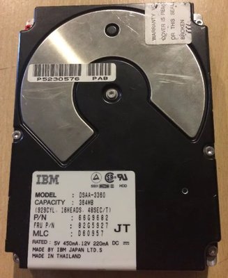

It did not come with a hard-drive
I think these came with a Western digital hard-drive for IBM.
If not I plan on using a WD drive because they are inexpensive and available.
The IBM drives are rare and expensive and hard to find a good quiet one.
The WD drives are quiet too.
I know some newer 486 IBM computers used WD drives.

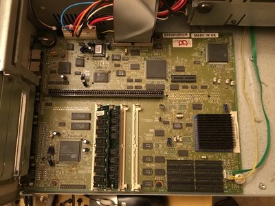

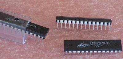

Also I want to upgrade the cache to 256kb because it only has 8kb onboard right now.
All the cache slots ( 8 ) are empty and the tag slot is empty too.
Can I use any type of cache or do I need a specific brand ?
Right now I have -15 and -20 cache 256.

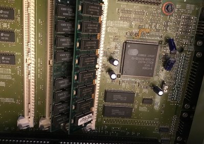

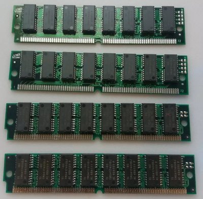

Right now it has 20mb of ram. 4 ram slots.
I want to max this out.
What is the max ram config I can use ?
I only have two ram sticks right now.
It currently has an Intel 486 DX2-50 CPU.
I have an Intel Overdrive CPU DX4-100, Should I install it ?
I have a 2mb Cirrus Logic GL-5429 video card. Should I use it or is the GL-5428 1mb. good enough.
It has a modem. Not sure what speed but it is a conaxent model.
I have a 3com 3c509b Combo Ethernet IIi ISA card I can use or should I use and Intel or IBM network card ?
Question: Restore to original specs or Max out the motherboard ?
Use only IBM parts or is IBM compatible okay ?

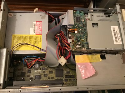

Reply 1 of 47, by Intel486dx33
More photos.
Reply 2 of 47, by Intel486dx33
I have ordered 64mb of Texas Instruments FPM ram.( Made in USA ) Which should max out this computer although there are 32mb SIMMs available now too so maybe it will support 128mb max ? I am not sure ?
Also I have an original IBM hard-drive coming.
And some Cache ram. 265kb.
And an Intel 486dx4-100 overdrive CPU.

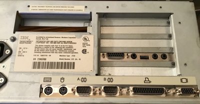

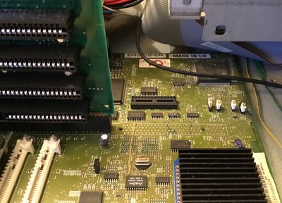

Reply 5 of 47, by Intel486dx33
Need jumper setting for this motherboard ?
IBM PS/1 value with 486dx2-50
Machine type 2155
Model # 87c ( SL-B)

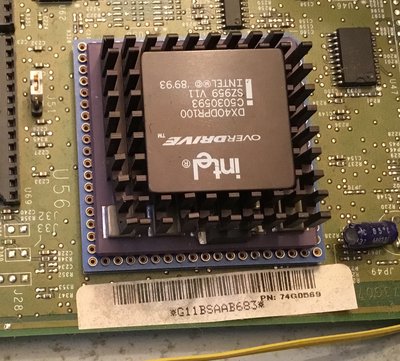

Reply 6 of 47, by Intel486dx33

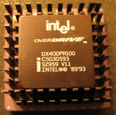

Okay, I have installed the Intel 486dx4-100 Overdrive CPU and IBM 730mb hard-drive.
And all is working fine.
I am still waiting for the RAM to arrive.
I could NOT get the cache to work because I do not know the jumper settings to this motherboard.
Does anyone know the jumper settings to this motherboard ?
Update:
I just received the 64mb of ram and it works fine just like the IBM hardware label reads

Reply 7 of 47, by cyclone3d
Here is a download for the hardware manual.
Pages 4-18 and 4-19 show/tell how to install and setup the cache:
http://ps-2.kev009.com/pccbbs/aptiva/63g2028.pdf

Reply 8 of 47, by Intel486dx33
Yes, I saw that already but this motherboard is different.

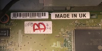

here are the part numbers and bar codes.
IBM motherboard Part number # 74G0569
IBM PS/1 Model 2155-24M
Reply 11 of 47, by SpectriaForce
Does the DX4 Overdrive run at 100MHz? When this pc was designed, that CPU was not released yet.
By the way; upgrading the RAM to 64MB is useless unless you are going to use Windows 95 with a memory hungry database or CAD program 😉
Reply 12 of 47, by Intel486dx33
PC Hoarder Patrol wrote:
That’s what I have been searching for. I don’t have the VLB riser but the motherboard jumpers are the same.
Thanks.
Reply 13 of 47, by Intel486dx33
I can only get this CPU to run at 75mhz. Is that going to be okay ?
Or should I put the original 486dx2-50 back in ?
How much ram do I need for good Win 3.11 performance ?
Reply 14 of 47, by SpectriaForce
Intel486dx33 wrote:
I can only get this CPU to run at 75mhz. Is that going to be okay ? Or should I put the original 486dx2-50 back in ? […]
Just 8MB for most games and other apps. DOS games for a 486 usually require anywhere from 4-16MB. 16MB makes it run Windows 95 already quite smoothly.

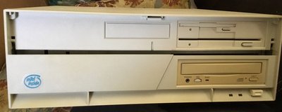

Reply 15 of 47, by Intel486dx33
Now that I have confirmed everything works and have everything working.
I am going to clean this up and put it back together.

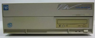

What is the best solution to clean this yellowed plastics with ?
It’s just the CDROM that has yellowed.
Reply 16 of 47, by red_avatar
Intel486dx33 wrote:
Now that I have confirmed everything works and have everything working. I am going to clean this up and put it back together. […]
Check eBay to see if they don't sell front-ends for your model. Retrobrighting is the only other solution but it's very tricky to get the right shade - I've done a few retrobrights and some parts went "too far" making them paler than the original colour used to be.
ALSO: I don't quite get where you're going with your build. I'm very much someone who likes period-correct PCs in the sense that they offer the highest compatibility. That's why I have half a dozen retro PCs, each aimed at a specific moment in time offering certain combinations of graphics, sound, OS and memory that runs 95% of games released within that era.
I have an IBM PS/1 as well as its successor (the Aptiva Multi Media) and I actually turned back some upgrades because I felt they weren't needed. 16MB is more than you'd need with a DX2/50 or DX4/100 and some games won't properly work if you have more (heck some don't even work if you have 16MB) so unless you want to run Windows 95/98 I'd just stick with 16MB. DOS isn't a modern Windows: more memory won't do squat except drop compatibility. The few games that can use more than 16MB need Pentiums anyway (I believe Queen The Eye is one such game - ran like crap even on my Pentium 166)
As for hard drive: if I were you, I'd to a CF-to-IDE card (slotted at the back) which is really really handy to quickly move data back and forward. A DX4/100 Overdrive isn't a bad upgrade though - the speed benefit isn't as clean as with a proper DX4/100 but it's still a nice boost.

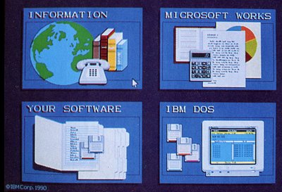

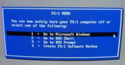

Well, these IBM PS/1’s multimedia editions where the first of there kind when PC manufactures where migrating to Multimedia computers. I just want to restore this one to get the optimal performance out of it.
With period correct components except for the Overdrive CPU of course.
I think you are right. These came late to the show because by late 1994 Pentium and 4x CDROM drives where available. But these are very nice 486 computers. And I really like the IBM simplicity that they but into there
Operating system menu.
That’s why I think these are the Cadillac’s of the 486 computers.
They where very simple to operate almost like a Mac.
Reply 18 of 47, by red_avatar
I have three IBM's with that menu and I do love it - I tried to emulate it in DOSBOX because I love the idea of having a main menu to fall back to. When I first used my friend's clone 486, it felt so weird being "stuck" in DOS. IBM also made it very easy to use DOSSHELL - my friend didn't even know DOSSHELL existed until I told him about it since on a clone PC, you just booted to DOS prompt by default.
But yeah, I wouldn't overdo it - just get the high end of what "normal" specs were like back then and you'll have a very smooth and compatible experience. Mine is set up like this:
