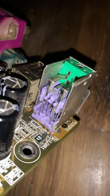

Since some time my pc has keyboard errors. Connection dropping for a minute and then reconnecting without issues first, but now I can hear the pc speaker beeping when it's plugged in. It works for a couple of seconds, disconnects for a minute, works again etc.
The ps/2 port looks worn out, just like the mouse ps/2 port but that one works fine. I can see the keyboard LEDs (num-lock, etc) blink when powering on the pc, but still it will give a keyboard not connected error or it will boot but with an unusable keyboard. Last week when it still worked I could play a game for an hour and it would suddenly display the disconnecting behavior, and that wasn't because I pushed the PC case or touched the keyboard cable.
What gives? I can order a new 2 port PS/2 socket and solder that in, but if there's something else I can check I'd prefer to not desolder anything. I've had this board for ~10 years and it never had these issues, they started a couple of months ago but have now gotten so worse that I can't use a keyboard anymore on the PC. Motherboard is Asus CUV4-X by the way.

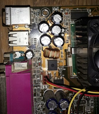

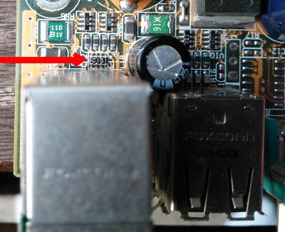

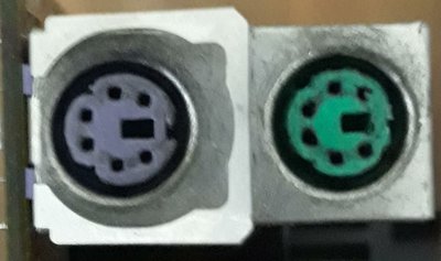

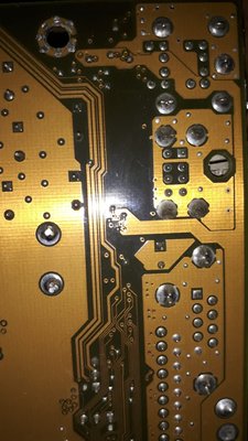

Sure. here are some pictures:
115.8 KiB
2282 views
Outside port
128.24 KiB
2282 views
Inside port
169.43 KiB
2282 views
Backside pcb (top right is port location)
362.42 KiB
2282 views
Area of ports
If you need more information let me know
Reply 3 of 17, by PARKE
The problem you describe is not uncommon on ASUS motherboards of that period.
https://www.badcaps.net/forum/printthread.php?t=829&pp=40
oooooooo
Quote:
After later look at ASUS's NetQ Forum found that the problem in Asus motherboards in certain types or the more common, these motherboards models include CUSL2, CUSL2-C, CUSL2-M, CUSL2-C-BP, TUSL2-C, TUSL2-C, CUV4X, CUV4X-C, CUBX, A7VPRO, etc., with the motherboard model and also having this problem
oooooooo
The fix that is described, removing chip c151, seems to work in some cases.
611.63 KiB
2260 views
This fix did however not work on my own CUV4X-ME which had the same keyboard problem and, sadly, that board had to be retired after the operation.

Interesting! Never expected something like that. Unfortunately I don't have a soldering iron atm, but when I get one I'll remove it. Would it be better to replace it with a new component? What is it anyway, a capacitor?
Keyboard is now working again for now.. actually typing this post using the ps/2 port. It'll probably disconnect again in a bit. If it's indeed the c151 chip then it must have failed last month because I never had these issues before. It also doesn't affect the mouse ps/2 port because that always works.
Thanks a lot for this information. I'll post back here when I've removed the component, but that will probably take a while as I need to buy a new soldering iron.
