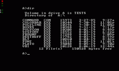

I've recently borrowed a Mindset computer, for the purpose of writing new software for it, and am writing it in Watcom C 1.9.
Currently set to generate 80186 instructions, with texan optimizations.
Thus far, I have brought up a copy of PLATOTERM on the system:
https://www.youtube.com/watch?v=e0VZveLqMoY
This uses polyline, polypoint, and a few other BLT functions to do output, and works okay....
However, I am trying to get BLT COPY from this document, to work properly:
http://www.bitsavers.org/pdf/mindset/Mindset_ … opers_Guide.pdf <-- page 4-43
And I've thus written so far:
https://gist.github.com/tschak909/75a7e9e6804 … 3019820e10c9c19
and all I see is a sea of blackness. argh It's something I am doing wrong.. wtf is it?
Reply 1 of 19, by bakemono
Interesting, I don't recall hearing about this Mindset system before.
51        blt_params[0]=FP_OFF(blitdata);          // Source offset
52 blt_params[1]=FP_SEG(blitdata); // Source seg
53 blt_params[2]=8; // 16 bytes?
54 blt_params[3]=0; // X source offset
55 blt_params[4]=0; // Y source offset
56 blt_params[5]=128; // X dest offset
57 blt_params[6]=128; // Y dest offset
58 blt_params[8]=16; // X width in pixels
59 blt_params[9]=16; // Y width in pixels
60 blt_params[10]=0xFFFF; // Source mask (everything)
Looks like you skipped 7? How about this instead:
58	  blt_params[7]=16;                // X width in pixels
59 blt_params[8]=16; // Y width in pixels
60 blt_params[9]=0xFFFF; // Source mask (everything)
Reply 2 of 19, by tschak909
oh wow *smack-head* thanks 😀
I've been writing a whole host of test programs trying to document the hardware, and I guess I've just been at the keyboard too long 😀
