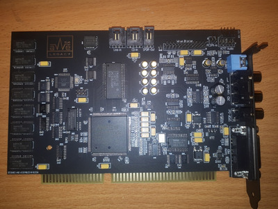

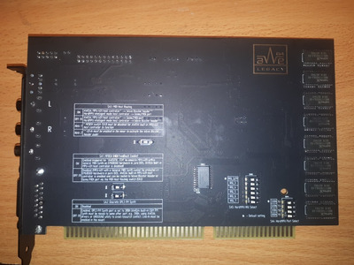

Hi guys!
I bought a PCB and soldered it myself. The payment came quickly (inside Russia). I have been waiting for components for a long time, because many chips had to be ordered on Aliexpress. And in another store, the delivery time was 6-8 weeks.
I have consulted with the board developer several times. Thanks to him for the answers.
ECAP C50, C51 should be 22uF x 50V. C40-C49 should be 4.7uF x 50V (note for PCB rev. 1.2.1) The developer has probably already fixed this in BOM.
I also spent a long time picking up analogs of a quartz oscillator and a quartz resonator due to my lack of experience.
I also badly soldered memory chips with "J" pins with hot air. I had to remove them and solder them with a soldering iron with a "J" soldering sting. After that, the memory card passed the memory test.
I didn't find a programming adapter for Atmega and programmed it through the DBG connector on the PCB.
I haven't tested the Hard-MPU because I don't have a Roland MT-32. The rest of the board functions work!
Thanks to the developers for a good project!
