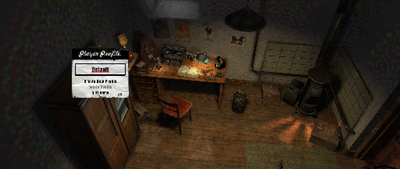

Dege wrote:
dgVoodoo always renders in (at least) 32 bit internally so you'll get the same result.
But, it's not the same result.
16bit + ordered4x4 (WARP)(doesn't dgVoodoo dither banding thats baked into textures?)

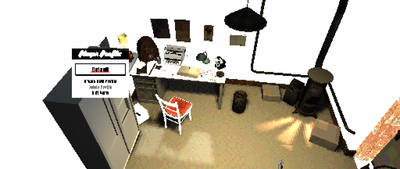

Dege wrote:
Forcing dithering on 32 bit rendering (selected in a game) is just an extra. You can look how the game would look if it used 16 bit rendering with dithering.
32bit + ordered4x4 (ok, if this is "game would look if it used 16 bit rendering with dithering", then what the hell is that previous image? 256+dithering? 😁)
282.65 KiB
1427 views
I want that 16bit + ordered4x4, but in non-WARP I get this
126.72 KiB
1427 views

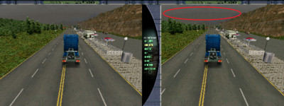

P.S. On the same note, I fail to understand how there can be dithering and banding at the same time. I am so confused.
341.9 KiB
1423 views

But, it's not the same result.16bit + ordered4x4 (WARP)(doesn't dgVoodoo dither banding thats baked into textures?)
Ok, you're right. I forgot about the fact that if textures are also 16 bit then indeed there is difference because quality loss comes from the textures themselves even with 32 bit rendering.
Dithering isn't baked into the textures. It's a postprocess step at the end of the frame on the final image.

Bands are too large in extent to suppress their presence with a little 4x4 dither-matrix.
