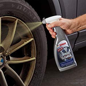

Reply 6 of 17, by DaveJustDave
So... I do a lot of auto detailing for fun, and there is a product called Sonax Full Effect that i use on my wheels. It's designed to bind with iron particles in brake dust. I've soaked rusty bits in this stuff (just spray it on and let it sit for a while) and it does a great job.
