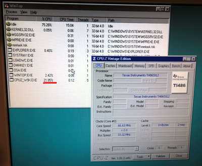

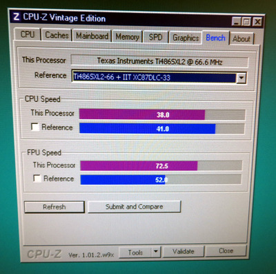

I also ran the benchmark. TI 486SXL2-66 with ULSI US83D87-C-66 on an AMI Mark V Baby Screamer motherboard based on the VLSI Topcat chipset.
147.7 KiB
1109 views
Looks like kixs system was a bit faster for CPU, whereas mine was much faster with FPU due to the clock doubled FPU. Do you have any plans to add FPU detection to CPU-Z?
Something else I noticed is the idle load of CPU-Z. It consumes between 21-29% of the CPU at idle. Is this normal?

Reply 245 of 440, by CuPid
feipoa wrote on 2020-04-20, 09:43:
I started working on that but didn't go very far. One of the tricks used for detection required an exception handling, that is unchieveable under win9x, so I stopped (maybe too early).
Not normal, but this is not a suprise. The diet to adapt the code should be more intensive for CPUs below 200MHz.
Wintop is part of powertoys for windows 95, is it ? it is available for free ?
