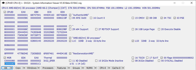

Reply 306 of 440, by red-ray
Imperious wrote on 2020-06-29, 12:45:
Overclocked IBM/Cyrix MII PR166@200mhz, and stock AMD K6 266 (66X4). I am curious why cpuz has no problem detecting fsb and multipliers on
the 6x86 chips but can't on the AMD K6 on the same Motherboard which is a EPOX EP-MVP3G5. The K6 is not a k6-2
On the MII the multiplier comes from the Cyrix DIR0 register and on a K6-2 from MSR C0000087, but I don't know if a K6 has MSR C0000087. Can you boot NT4, W2K of WXP? If so then check if SIV reports it on Menu->Hardware->CPUID->CPU-0. We can't sensibly check if MSR C0000087 exists using W9X as it does not support kernel mode structured exception handling.
file.php?id=87036
    34.04 KiB
    1520 views
    K6-2 has MSR C0000087

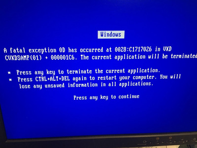

Reply 311 of 440, by CuPid
pete8475 wrote on 2020-07-18, 18:50:
The Win98 version of CPU-Z causes a blue screen on my Asus TXP4 socket 7 machine.
I'll hook it up tonight and post more details then.
Thanks for the report.
What CPU is installed ?
I need a vacation.
Reply 312 of 440, by pete8475
CuPid wrote on 2020-07-21, 16:14:
AMD K6-2 400mhz.
I'm booting it up now and I'll take note of what the bluescreen says.
EDIT - Took a picture with my phone.
    111.29 KiB
    1392 views

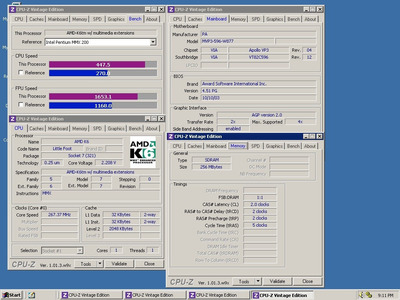

Reply 314 of 440, by red-ray
pete8475 wrote on 2020-07-21, 20:01:
AMD K6-2 400mhz.
Exactly which model? I expect SIV32L will report this, does it and does Menu->File->Save Local run OK please?
RayeR wrote on 2020-07-21, 21:28:
Just a guess, couldn't it crash due to used CMOV instruction that is not available on K6? Quiet common problem...
Unlikely as CPUZ runs OK on my K6 (Little Foot).
    98.41 KiB
    1373 views
Reply 315 of 440, by CuPid
Thanks pete8475. Seems like an undesired MSR reading to me. I fix that and let you know.
Edit :
pete8475, can you please try that version and let me know ? if it works, can you please post a TXT report ? Thanks.
https://download.cpuid.com/betas/cpuz_w95_dbg.zip

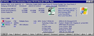

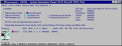

Reply 317 of 440, by pete8475
red-ray wrote on 2020-07-22, 20:30:
AMD K6-2 400mhz.
Ran that program, hopefully these screens show you what you want to know.
    43.49 KiB
    1354 views
    56.44 KiB
    1354 views
