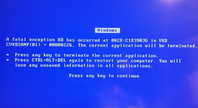

CuPid wrote on 2020-04-16, 12:12:
appiah4 wrote on 2020-04-16, 10:43:
I can't seem to get CPU-Z to run on Win9x, gives me a bluescreen at startup around the 10% initialization mark, and the followin […]
I can't seem to get CPU-Z to run on Win9x, gives me a bluescreen at startup around the 10% initialization mark, and the following error:
"A fatal exception 0D has occured at 0028:C15F3D96 in VXD
CVXDSAMP(01) + 00000226. The current application will be terminated."
Probably a PCI probing problem? Any workarounds?
It is very likely an unsupported MSR that the program is trying to access. NT handles the exception, but win9x doesn't.
Can you please tell me what CPU is installed ? (its family/model/stepping if possible, and its codename)
Having the same problem on a Soyo 6BA+ IV with a Pentium 2 400 on Win98 SE

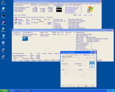

Reply 405 of 440, by dormcat
Hi CuPid,
Soggi suggested me coming here to report the problem under the "Graphics" tab:
file.php?id=120054
Looks like VE 1.03 reported even less info than 1.78; both have far less info than Everest or SIV32. Is it possible to have the Graphics detection improved in the future version? Thanks in advance.

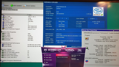

Hello
I recently been playing around older GPUs, and found an issue with Legacy CPU-z and i740 AGP card I own.
It crashes with this error :
98.34 KiB
3746 views
During GPU detect phase on my Slot-1 440BX motherboard.
Only CPU-z crashes, Windows is fine/able to recover.
Platform :
PIII Katmai 500MHz + Gigabyte "BX2000+" MB + i740 8MB card
523.94 KiB
3746 views
OS : Windows 98 SE
Driver used for Intel card : PV4.0 (PV40_9x.exe)

Reply 408 of 440, by CuPid
agent_x007 wrote on 2021-11-06, 09:57:
Hello […]
Hello
Platform :
OS : Windows 98 SE
Thanks for your test. Just to be sure, if you put another graphic card, the problem does not occur ?
I need a vacation.
Reply 409 of 440, by agent_x007
CuPid wrote on 2021-11-07, 11:29:
Yes. With both Riva 128 and ATI Rage 128, it worked fine.

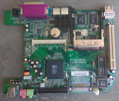

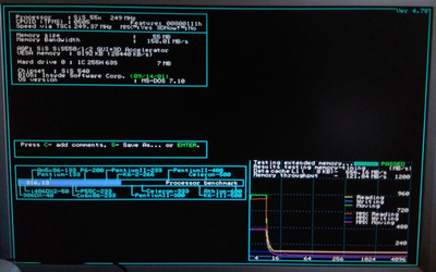

https://valid.x86.fr/2y4kn2
This is from a SiS552LV Processor
It has 8K of L1i and 8K of L1d
Not all that much is known about these VorteX86 based designs

I have a Packard Bell Celeron 700 here with PCI only graphics and it also bluescreens with the cvxdsamp error at about 60% loading. I've tried a couple of different graphics cards but they do the same - GeForce MX200 and a Matrox Mystique.
The motherboard is a Gigabyte GA-6WMM7 Rev 4.1
