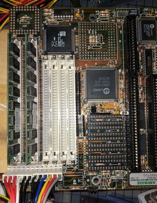

Ok, I'm at a loss here... I got a nice little 386DX40 board from a box of stuff:
https://www.arvutimuuseum.ee/th99/m/S-T/32636.htm
352.89 KiB
577 views
The board had two W24257AK-15 cache chips on it, one in U10 where the TAG cache sits according to the layout, and one in U11.
I did not further investigate this at first (as in look up the board or cache setup) I just tried turning it on, and it would not post, I held my finger on the CPU and gpu to see if they're warm... and when I wanted to turn it off again I accidentally slipped with my finger over the cache and almost burnt myself, they were scorching hot.
I had a really hard time taking the cache out because they were jammed in the sockets and there was no space really between the ISA and ram slots.
After I removed the cache the board bootet up.
So far so good... cache defective? can they really get that hot if they're defective?
So after looking up the board and reading a bit it says there should be one 8K x 8 in the TAG socket and 4 32K x 8 in the cache sockets
the chips that were in it are both 32k x 8... so now I got one W2464AK-20 8K x 8 for TAG and 4x W24257AK-20 32K x 8, this should be the correct setup?
This time I put some cut cable ties underneath the chips so there would be a little bit of wiggle room to get them out again and put them in.
...turned the power on... and saw smoke rising 😵 immediately turned it off again, and yes... the cache was scorching hot again, I couldn't even touch it, almost burnt my finger again just trying, it was maybe on for a second.
I assume the smoke came from the plastic of the cable ties underneath and not the cache chips themselves...
so did I just kill a bunch more cache chips? or are all of them defective? 😵
I can't see any obvious fault or damage on the board apart from the missing battery.
does anyone know what could cause the cache to just burn up immeaditely upon turning on the system?
Luckily the board did still turn on after removing the cache again, phew.
I don't want to kill the board or more cache chips by trying out stuff, so I thought I'd ask if anyone knows what could be the culprit here?
Thanks in advance.
edit... okay call me crazy but... uh I just measured the sockets with my multimeter, and VSS/VDD seem to be entirely the other way around
are they just inserted the wrong way?
if so, the picture on TH99 is wrong, as it shows the notch towards the ram slots, and apparently the old cache was also inserted this way.
Reply 1 of 12, by dionb
Fire up the board without cache, get out the multimeter and check whether 5V is really coming out of the pins it should be coming out of. This almost sounds like the sockets are the wrong way round or something...
Reply 2 of 12, by imi
thank you, I just did that while you replied, that seems to be exactly it.
unfortunately the image on TH99 is wrong apparently (or they are not the same boards 😕 ) and there is no indication on the board about orientation, but apparently whoever had the board before me did run into the exact same issue.
so can I assume those cache chips are dead now? or can I still try them the RIGHT way around?
edit: it would post now, and the cache doesn't burn, but kept hanging during boot and didn't recognize all ram.
that either means that yes, the cache is busted now... or could it be that the tag chip is at the wrong socket, that those are flipped too?

so upon searching through vogons I came upon this thread featuring the same board:
Some questions about 2 386DX-40 mobos
and at least according to this picture the tag cache seems to sit on the opposite side, so the whole thing is 180° around... I currently have the 8k x 8 chip sitting in the outer most socket as per the image from TH99, I don't know what the expected behaviour is with the tag cache sitting in the wrong socket, but I guess I should try flipping them around?
I wish I had a manual for this board ^^
edit: uh yeah, sure enough, now it detects all the ram again with cache enabled, the TAG goes in the inner socket like on the other photo, the whole cache setup on TH99 is flipped 180°
that cost me 5 chips 😢 +the 2 probably already dead ones that were on the board.
quoting myself here...
I stumbled upon the picture I took for this thread yesterday while looking through stuff... and actually saw that the cache sockets are indeed marked with an orientation, there is a '1' and a '28' on the socket indicating pin orientation, idk how I totally missed that the first time around... but IT IS WRONG... the sockets themselves are mounted on the board in the wrong orientation.
so yeah I can see how someone made same mistake before me, and how the error on the drawing of the board came to be.
