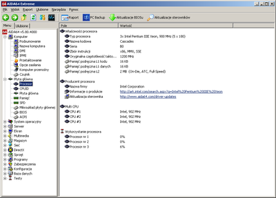

Reply 899 of 1037, by GL1zdA
red-ray wrote on 2022-10-24, 20:25:
I noticed the speed reported by CPUZ 1.74 looks to be incorrect, I assume it should be around 1000 MHz rather than 1138.81 MHz, should it? I am also wondering if this has been fixed in CPUZ 2.03.0.x32, has it?
Both 320 and 540 should work at 100 MHz FSB. There are no settings to change it, and I've never heard of anyone overclocking it, so It looks like a CPU-Z oddity.
On my machine, AIDA64 was the program that showed odd results. I've checked my station in 2017 with then current version 5.80, and it reported my 900 MHz Xeon running at 5x180 MHz. I think this was because the motherboard was jumpered to 5x, because Tanner Xeons required it, and I've run 500 MHz Xeons in this station before. I didn't change the settings for the 900 MHz CPU, since it would override any setting to 9x anyway, but it looks like it was somehow still "visible" to AIDA. AIDA64 reported the "factory" speed for this CPU as 1200 MHz (9x 133 MHz), but these parts operated at 100 MHz.
    40.22 KiB
    883 views
    AIDA64 CPU tab on a Visual Workstation 540
