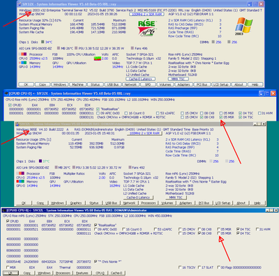

I wonder what happens if an RDMSR is done in User Mode and it's not supported, maybe the exception is other than GP, getting Invalid Opcode Exception (#UD) would be good.
After pondering I decided to see what happens with my Rise mP6 (Lynx) which does not have MSRs. On 98SE the RDMSR failed with 0xC000001D: Illegal Instruction, but on 2003 it failed with 0xC0000096: Privileged Instruction so I guess 2003 must have emulated the RDMSR, as a result SIV decided MSRs were supported which is not what I wanted 🙁
file.php?id=154278
    71.45 KiB
    1470 views
    Rise mP6 (Lynx) 2003 vs. 98SE
    40022.PDF
    206.87 KiB
    50 downloads
    Search for DIR0

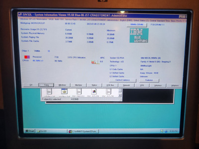

Thank you for for confirming [Serial] triggered the issue, in the attached SIV32L 5.68 Hope-06 I hope I have fixed this, have I? If not you could do Menu->File->Save->Save Selected and deselect [serial] to circumvent the issue.
NT 4.00 has several advantages over 3.51 with the main one being is that it supports Kernel Mode SEHs meaning SIV can sensibly read MSRs. It also supports CP_UTF8, correctly handles SIVRES.dll and with SP5/SP6 you can have much larger disks. Back in the mid 90s I moved from NT 3.51 to NT4.00 on an i486 DX-50 ISA only system with 20MB and seem to recall speed wise they were much the same.
I have also added some trace code, please do SIV32L -DBGCPU and post the generated SIV_DBGOUT.log in addition to a new save file. With luck it will report IBM 486-BL and get the correct speed, but I expect I will need to make further adjustments.

The attached SIV32L V5.68 Blue-06 should do better on NT 4.00.
BTW if you press [ Copy ] it will copy the panel to the clipboard and you can then paste it into such as paint.

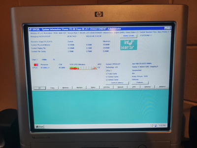

I was only expecting you to test on W95C and have not added CPU detection code for NT 4.00, what does SIV report on W95C? [...] The attached SIV32L V5.68 Blue-06 should do better on NT 4.00.
While I'm happy to report NT4 is now showing correctly, 95 is not. I could nitpick and say that the Blue Lightning is QFP, not PGA, but there's no way for the software to know that. Bus speed is actually 33MHz, but everything seems to misdetect that.

Thank you, things are now starting to make sense. I have attached SIV32L 5.68 Disk-06 which should fix the FSB speed + Disk SMART reporting on NT. The current state is:
  1. I need the SIV_DBGOUT.log file from W95C to be able to figure out why 486-BL is not detected. In the NT4 one there is SIV32L CPU-0 EC C0000096, the W95C should have the same, but I suspect it's different.
  2. The disk SMART reporting should have worked and does on my NT4.00 SP6a systems, I have tried to work around this, but suspect if you installed SP6a it would just work.
  3. Looking at Menu->Help->SIV Lookup I can see the dbghelp + psapi DLLs are missing, please put the ones from Tahoma Font+DBGHELP+PSAPI DLLs for NT4.zip onto the system.
  4. I suspect many of the SIV tooltips report COMCTL is too old, to address this you would need to install IE5.5 which installes a later COMCTL. I will also install the missing wininet.
  5. I was hoping the BIOS POST screen would report the motherboard model and BIOS version, does it and if so what are they?
  6. I would put all the attachments in one .ZIP file assuming it's <= to the 5MB size limit.
  7. I can't see why a GPU is not reported on NT4.00 so please use the SIV32L -DBGCPU -DBGGPU -DBGSDM > SIV_DBGOUT.log | more command.

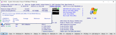

Reply 975 of 1037, by red-ray
Sedrosken wrote on 2023-01-05, 20:10:
It still does not correctly pick up on my video device, though I didn't really expect it to.
I have just uploaded SIV 5.68 Beta-06 which should fix the reporting none PCI GPUs on Windows 95.
It worked when I tested it on W95B with my Kelvin-64/ISA which is the only none PCI GPU I have, given this I would be interested to know if it works in general.
file.php?id=154861
Irinikus wrote on 2023-01-10, 10:06:
Did you know this is broken? It reports "Dang... Something went wrong! We tried really hard, but it's broken.Talk to your Gallery administrator for help fixing this!"
    48.74 KiB
    1193 views
