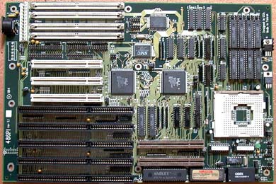

I think I have a Socket 5 board manufactured by AIR with the Mercury chipset. I'm struggling to find the model name without pulling the board out of storage. IIRC, the board may have VLB and PCI slots, too. It's also tricky for me to find a list of AIR boards that were released. IIRC, there was an antiquated East Asian website with dated pictures that had an image of the board - anyone recall the site?

Thanks for the links. I think it may have been the bottom link, although I can't see the AIR board I was referring to. There are AIR boards linked, but they don't have the slot configuration. My board has 5 ISA slots, 1 or 2 shared VLB slots and 3 PCI slots.. Thinking about it more, it may have the Intel Aries chipset rather than the Mercury chipset...
EDIT:
Found it. This is a Socket 3 board and not a Socket 5 board.
