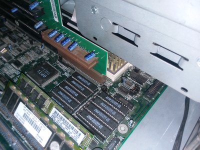

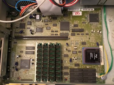

While this PC isn't technically complete, it's only missing one piece (sound card), so I figured that I might as well document it here.
It's an old IBM PC, post-PS/2 era, which is in reality about the same as any other old 486 clone, as far as I can tell. It came with PC-DOS and Windows 3.1, and had files and programs indicating that it was used in an automotive shop. It was specifically used in the garage itself, because when I got it, the entire inside of the case, the motherboard, the RAM, CPU, PSU, everything, had black chemical-smelling dust all over it. It looked like Hell, and while it doesn't look great now, I think it definitely beats what it looked like before.
I figure that when the bright minds over at the aforementioned automotive shop bought the thing, they took off the L2 cache from the custom order form. I'm guessing they thought it costed extra money and just ordered the PC without any cache- same goes for the sound card. Of course, in saving that US$100-US$200 (I have no idea how expensive the stuff was back then), they reduced performance in even Windows by an unholy margin. I had to get the 256KB of cache myself on eBay, and I also had to give it a new IDE CD-ROM drive as the old SCSI one in it failed at some point before I got it. The original ~500MB HDD works, but I can't remember the exact size of it. Might have been 540MB. Anyways, it's what I'm using for now until it dies. When I got it, it had 12MB of RAM, upgraded from the original 8MB it probably came with, though it may have come with 12MB of RAM seeing as both RAM sticks have IBM part numbers and branding on them. I like to think that those geniuses realized that it was too slow and so tried upgrading the RAM to make it "go fast." It didn't work very well.
I'll grab some pictures later on, right now I'm going to install DOS/Win 3.1 and see how well it does now that this thing finally has some friggin cache.

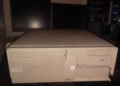

Reply 1 of 8, by athlon-power
471.39 KiB
1167 views

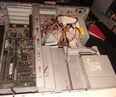

The 486 DX2-66 unit itself. I managed to try to repair the front panel a bit and clean it up, as it and the case itself were coated in an inordinate amount of black dust. It did not have the 5.25" bay blank, nor did it have the blank for the little slot beside the 3.5" FDD. I had to cut up and sand down an old 5.25" bay blank until a piece of it fit in that slot properly, so I sort of "replaced," that little cover. Also, to the far right, you can see the failed 2008 build I attempted a while back. Since I realized it wouldn't interact with the CPU right, it has sort of just sat there, doing nothing.
651.09 KiB
1167 views
Even though the cable management looks messy, I have all of the cables routed up and away from a little airflow channel that is created when you install a front panel fan. The area from the CPU to the rear air intake of the PSU is all completely free of cables, so not only does the PSU get fresh, active-flowing air, but the CPU also gets airflow over the heatsink, something that old DX2-66 could do with. While it isn't strictly required, I want to give both the CPU and PSU an easier time with cooling, due to their age.
1.08 MiB
1167 views
The DX2-66 with the integrated heatsink is poking out of the corner there. I didn't want to remove the ISA backplane because it is held rigid with a metal arm that connects to the 3.5" HDD bay, meaning that I would need to unplug the hard drive and undo some of the cable management creating the airflow channel I took 30-45 minutes to create. The cache is also visible here, so I finally have something that acts less like a 486SX and more like something that acts like a true 486DX.

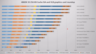

My question is why did IBM put such good graphics chipsets in these things? It's not like these were high-end machines by any degree, and if you look, both the model in your IBM PS/1 and the model in my PC 350 is better than even the TSENG ET4000 (screenshot took from a PhilsComputerLab video I found when initially trying to gauge the performance of my PC). This isn't even in just what SVGA resolutions/colors it can do, but in raw performance in things such as games.
This isn't to mention that I'm not using a DX-33, I'm using a DX2-66, which inflates performance even more than reflected on these charts. Keep in mind that this computer, with this powerful of a graphics chip, is the same computer that an automotive shop bought and abused slowly via chemical dust suffocation while they ran weird automotive certification exams or whatever on it. It didn't have any cache though, so they would've never been able to remotely experience this PC's actual performance potential.

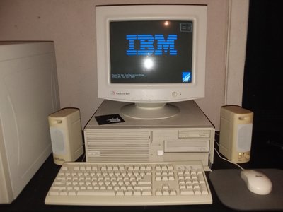

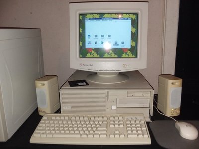

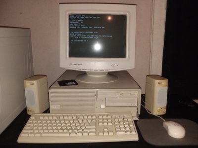

Here's a few updated pictures now that I've got it set up:

POST Screen. Not sure what the "SurePath BIOS," thing is about, other than that it's PnP, and does some other cool things.

The system booted into MS-DOS 6.22. It came with PC-DOS, but I ended up formatting the HDD and I prefer MS-DOS as I've used it the most.

Windows 3.1. Not much I can say here other than that I've added a few programs and extensions to it.
Here are the current specs:
IBM Personal Computer 350-466DX2 (Type 6581L5F, BIOS date 03/10/95, Motherboard OAEK8XJLU7I)
486 DX2 66MHz (It could be an Intel, an AMD, a Cyrix, or even an OEM IBM chip, I have no clue. The CPU has a heatsink glued onto it and the BIOS only says "80486DX2 66MHz.")
12MB 72-pin SIMM (1x 4MB, 1x 8MB)
Cirrus Logic 5430 VLB 1MB
540MB IDE HDD (No speed, I'll assume this is either a ATA-33 or slower drive)
Onboard IDE Controller (No given speed, same assumption as with HDD)
50-pin SCSI 4x CD-ROM
Future Domain 1680 ISA SCSI Controller
ESS AudioDrive 1869F
3.5" 1.44MB FDD
It uses PwrSCSI! Software which handily sets up the DOS CD drivers for me. I was using a 48x IDE CD-ROM drive before, but I recently got an external 4x SCSI CD-ROM, so I took it out of the enclosure, and threw it into the computer. So far, it's been working fine, knock on wood. The floppy diskette you see sitting to the left of the monitor is a DOS 6.22 boot diskette that I made to be able to play Wolfenstein 3D. Wolf3D doesn't like the SCSI drivers being loaded, and will say it doesn't have enough memory, so I made a boot diskette, copied the autoexec.bat and config.sys files over from my C: drive, and just removed all of the entries for the SCSI software, and the game launches fine. I'll probably use this diskette for any other software that doesn't run right with the SCSI drivers initialized. Both DOOM and Heretic run just fine with the SCSI drivers loaded, so this is more Wolf3D specific.
I still may try to get some 2fps gameplay out of Quake on this machine. I did, however, recently get ahold of a Pentium MMX 200MHz machine for US$5, which included the Packard Bell monitor I'm using for the 486 right now. It originally had the speakers on there, but seeing as I don't have a power supply for them at the moment, I took them off and put them into storage until I can get a power brick for them. I may end up saving Quake for that machine, if I can get it working right, that is.
