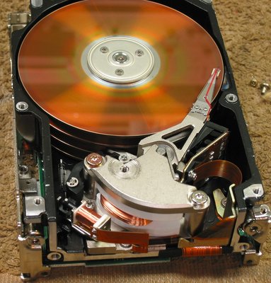

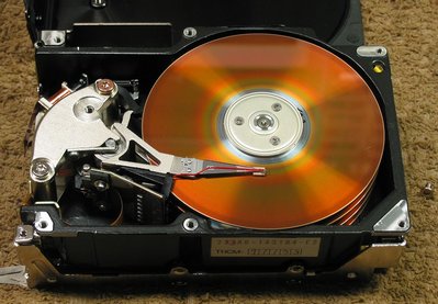

Reply 9 of 13, by cyclone3d
Do a teardown of the bad drives and post pics.

Reply 12 of 13, by cyclone3d
Not really. I just want to see a teardown of an MFM drive since I've never had the chance to take one apart.

Reply 13 of 13, by precaud
Here's the innards. This one is a Toshiba MK134FA 42MB MFM drive with four platters, seven heads. Not sure what if anything they do with the 8th surface. There is definite discoloration of the surface where the heads spend the most time. The errors were concentrated there, as well. I would say, this drive saw heavy use beore I got it.
The heads are moved across the platter surface by the little stepper motor in the bottom left of the 1st pic. The actuating length (motor to arm) seems pretty long to me, a possible source of errors.
