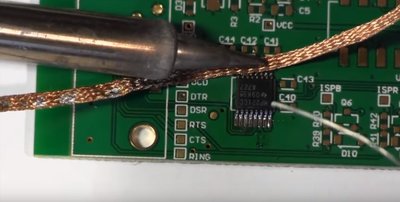

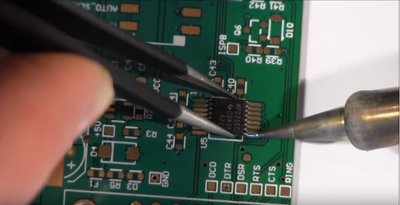

Yeah , I would use solder pastes on the pads and then set the ram chip down on the PCB pads and heat the legs with a heat gun
to the solder melting point. ( about 370 F ).
or
If needed you can apply flux to the pads and can load the solder iron tip with solder and drag solder the ram chip legs to the pads and then clean up excessive solder on legs with solder wick.
But solder paste and a heat gun should do the job.
Clean area with isopropyl alcohol and q-tips before and when done.
    69.67 KiB
    309 views
    59.52 KiB
    309 views
