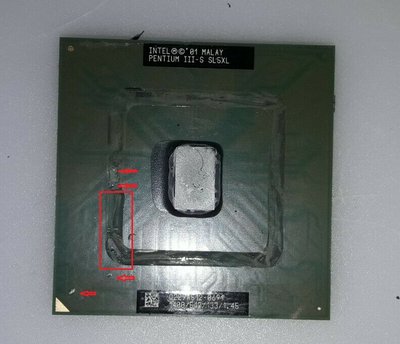

Hello, I have a retro pc with a Gigabyte GA-6VTXE motherboard and a Pentium III 1000EB cpu. I just found a good deal on a Tualatin 1400/133 SL5XL but it seems that its IHS has been removed.
Seller says that this won't be an issue and that any s370 cpu cooler will be sufficient. I have an intel box cooler as you can see in the following picture. What do you guys think? Should I go for it, or give it a pass? Thanks.

The PIII-S without the HS should be the same height as the Coppermine, so IMO the same cooler should fit.
Anyway you can easily check with the thermal paste that the contact is done correctly.

The heatspreader is mostly there (I think) to protect the core during installation. As long as you're careful it should be fine.
Maybe you could use some of those pads like Athlon CPUs from the time had on each corner.

Sure it will be fine, and there's certainly no problem de-lidding Tualatins - https://forums.overclockers.com.au/threads/pe … -delid.1136735/ - but it's maybe not the cleanest effort I've seen removing this particular IHS (the deformed bottom left gasket compound looks like they used the lever rather than the slice method which can risk damage to the board package surface) and I'd be double-checking the arrowed marks aren't exposed copper traces.

Those are easy enough to DIY too. Just stick some double sided tape on something suitable (used 1 or 2 mm gasket rubber sheet myself) and punch as many pads as you need with a hole punch, or simply cut them out with a knife or scissors.

Thanks for the input, hopefully the cpu works and I won't have to return it. My main concern was if the cpu overheats without the IHS, using a normal stock cooler but I rewatched Phil's review and came to the conclusion that it is more power efficient than the coppermine chips and thus gets less heated.

Update: The cpu works without a problem. Today I completed benchmarking and didn't occur any issue. Performance has increased significanlty as shown in the results:

cooling without a IHS is better than with an IHs
It doesn't matter for Tualatin though. TDP is too low.
