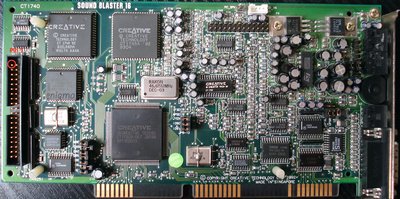

Reply 2 of 29, by Intel486dx33
That Sound Blaster 16 1740 has a propriety Panasonic interface. So that CDROM is most likely Matshusta. I have one in my IBM PS/1
You have to use the CDMKE.SYS driver with this sound card.
You need the Sound Blaster 16 drivers too.

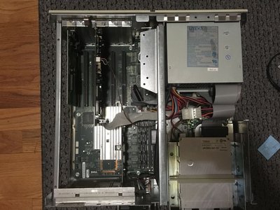

On first boot the 3.5 inch floppy drive made some horrible noises and the machine refused to boot from it. However, setting the hard drive settings to type 41 let it boot from that (it has EZ-DRIVE on it so I can access all 16 gigs of the DOS partition on it). I had some fun playing around with it to see what it can do. This drive already had a bunch of generic DOS stuff on it from a previous project, and only required some tweaking of CONFIG.SYS and AUTOEXEC.BAT to make it work fine with the Dell!
One annoyance is that the CPU has a heatsink stuck to it. I am really not sure how to get it off. I want to know what this socket is; there is an extra set of pins around the CPU and advertisements claimed this machine could be "upgraded with Pentium technology."
The machine opened up before cleaning
148.55 KiB
2012 views

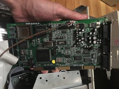

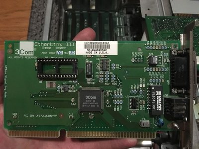

The cards that were in the unit

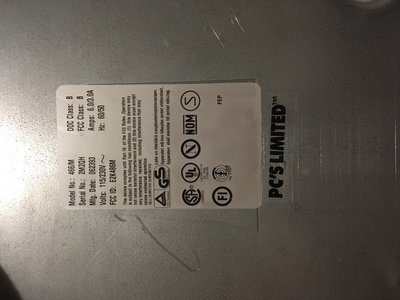

Holy crap, it's old enough to still have a "PC's Limited" sticker on it! Cool!

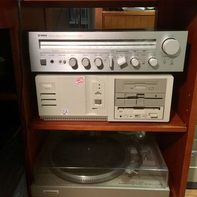

Looking snazzy on the newly christened Retro Corner of my desk.

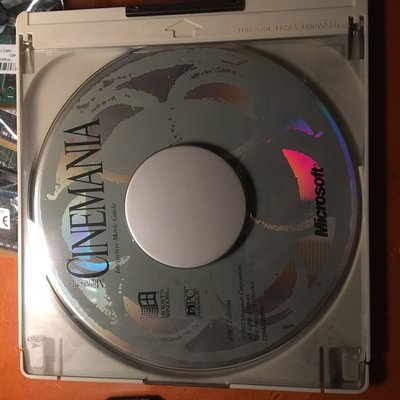

This was in the CD caddy when I opened it for the first time!

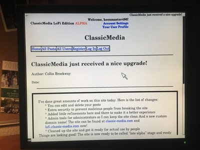

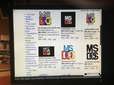

Doing some retro DOS web browsing with Links
115.28 KiB
2011 views

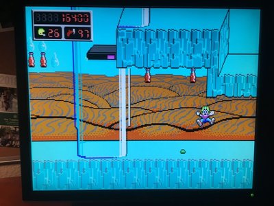

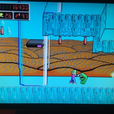

A valiant attempt
91.4 KiB
2009 views
Keen didn't make it =(
(these screenshots were brought to you by the B, A, and T keys on my keyboard)

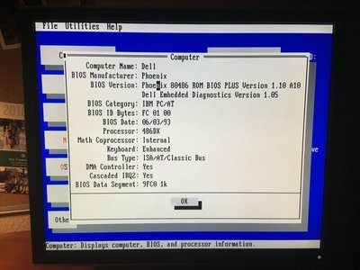

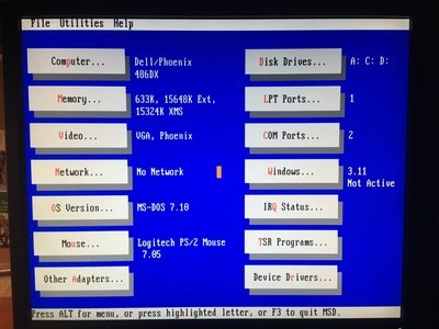

Some MSD stats!
103.71 KiB
2009 views
114.63 KiB
2009 views
As I suspected, the machine is indeed a 486 DX2/66.
Specs currently:
  • Intel 486DX2/66 (cache? Not sure)
  • 16 MB of RAM (may replace. I was getting some weird issues with Keen dropping sprites that I've never seen before, and random corrupted lines here and there in Wolfenstein 3D)
  • 250 GB HDD (might need more space, dunno if that's enough for a 486! Maybe I should put a 1 TB drive in there) -- really though there is just a 16 GB partition on it that I am running DOS from.
  • Some S3 onboard video card -- seems to be compatible with everything I've tried
  • Sound Blaster 16 CT1740 -- works great! A little noisy in games but running MPXPLAY it sounds amazing.
  • 3Com 3C509 ethernet card
All in all this is a great system to play around with! Stay tuned here for more projects and upgrades I may do with it!

Here is how I got the 3com 3c509 NIC working in DOS with packet driver and mTCP package.

I am attempting to get the CD drive working. So far after having loaded the drivers successfully, it will not spin up the disk. I will be checking cables tomorrow.
World's foremost 486 enjoyer.
Reply 11 of 29, by Zack_H
A lot of those early CD drives have SMD electrolytic capacitors in them that start leaking with age. That could very well be your problem here.
Starting Windows 95. . .
Reply 12 of 29, by keenmaster486
I'll look into that!

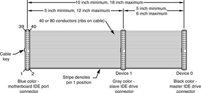

I ran into this problem too.
Make sure you have the cable hooked up correctly.
I think the red stripe on the ribbon cable goes on the right side of the IDE connector.

I reseated the cable on the CD drive and now it spins up the disk and attempts to read it, but it cannot read; just sits there making those characteristic squeaky CD drive noises forever and ever.
