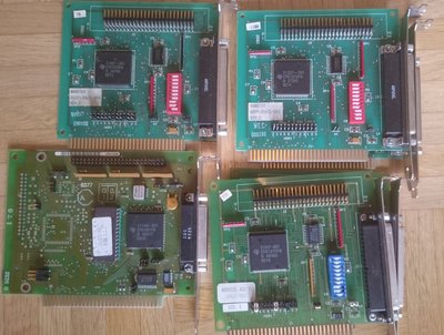

Also have some 8-bit cards, but only 1 with a BIOS. Dont think its a problem, you should be able to put the BIOS on e.g. a network card to boot from it - if you find the correct image.

The card with BIOS is a Seagate ST-01. Those are okay if you want to use hard drives (BIOS v3.3.1 or later required to run non seagate drives), but they don't have ASPI drivers so CD-ROM is not going to happen.
You can try a SCSI BIOS on an NIC with those other cards. It's worth a shot, but seems like a pain in the arse. I *think* the TI chips on those cards might be the same ones used on the future domain cards (even though they have VLSI chips). I think there was some of cross licensing agreement to produce those SCSI ICs. The ones on the Seagate cards are special though. They ordered a batch with some registers reversed which makes them incompatible with the TMC 850 drivers.
