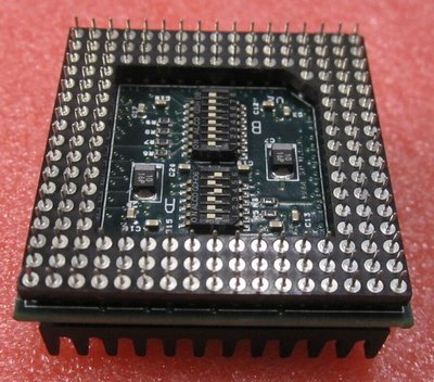

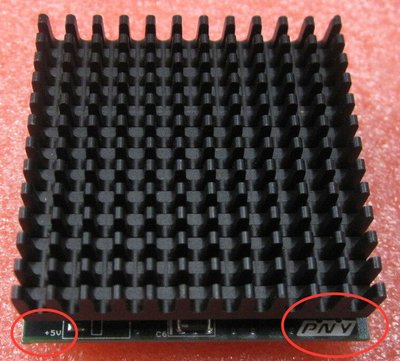

Does anyone have any info on this CPU.
PNY Am5x86-P75 AMD AM486DX5-133W16BHC Chip
Who manufactured it ?
It's an AMD 5x86-P75-133 right ?
it works on 25mhz bus and 33mhz bus with 5v.
Any info on the dip switches on bottom of CPU ?
I want to put it in my IBM PS/1 486sx-25 with 169-pin overdrive socket.

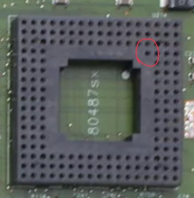

    110.72 KiB

Trinity Works Power Stacker 5x86. Bought a couple of those myself a few months back. These were designed to handle 5v systems.
PowerStacker 5x86

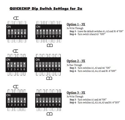

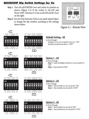

DIP switch settings:
https://web.archive.org/web/19980703090253/ht … switchreve.html

Should I use 3x or 4x in DIP switch settings ?

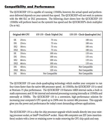

If your bus is at 33MHz, then to have CPU speed at 133MHz, you need multiplier to be ...?
The answer is even written on the box! 4th point.
Reply 7 of 34, by Intel486dx33
Okay, I see.
So I want to use 4x for a total speed of 133mhz on 33mhz bus.
and 3x for a total speed of 75mhz on a 25mhz bus.
Now,
Should I use "Pass through" or "Write through? ( this setting is for my motherboard cache right ? ).

Reply 8 of 34, by Intel486dx33
derSammler wrote:
Since the CPU was factory-installed, leave the dip switches as they are. They are correct already!
It's a used CPU from ebay and I don't know if the jumpers were tampered with.

The write-back settings are listed in the second page linked by Brickpad :
https://web.archive.org/web/19980703090959/ht … ddsettings.html
I have no idea of what pass-through mean.
I need a vacation.
Reply 12 of 34, by derSammler
CuPid wrote:
As most upgrade devices, it sets the L1 in WT mode for compatibility.
However, in this case this is also possible to force the WB mode, in case the BIOS would support it.
The L1 cache is inside the CPU. The rest of the system won't care or even notice whether it's WT or WB.
This is a combination of an adapter and a CPU. The dip switches are there to configure the CPU used. This has been done by the manufacturer already. So for the third time: don't mess with the dip switches, there's no need to.

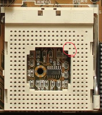

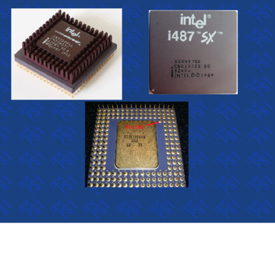

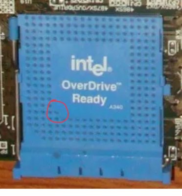

Reply 13 of 34, by Intel486dx33

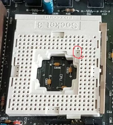

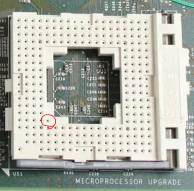

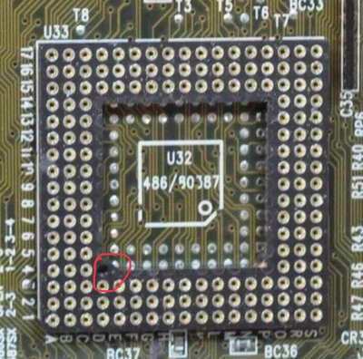

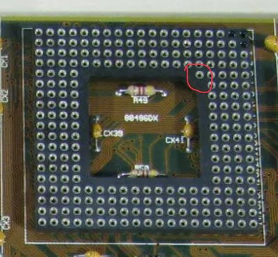

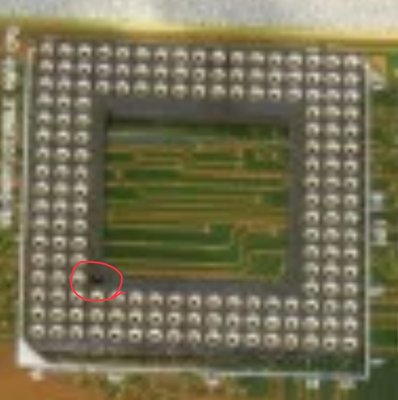

This CPU should work with most 486 motherboards right?
Even though it is a 169-pin CPU it will still fit in most 168-pin sockets and pin #169 should not matter if it is connected or not. The CPU should still operate right ?
Wether in an Overdrive socket to standard 168-pin 486 socket.
Almost all 486 CPU sockets have an opening for the pin #169 ( extra pin in middle of CPU ).

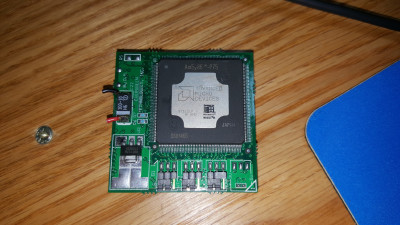

Reply 19 of 34, by mwenek
Hey all. I have one of these versions of the Am5x86-P75 (refer to photo!)
Any idea what the cut wires lead to?
My guess is an old fan that was cut off as it is an Evergreen Overdrive model.
I appreciate any insight before I fire it up.
Edit: Does the WB/WT cache option on this chip itself refer to its internal cache or the MB cache?
