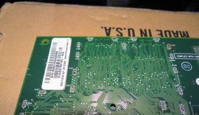

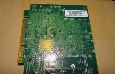

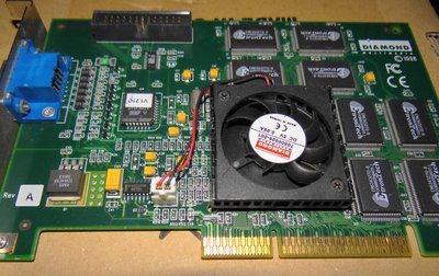

I have this AGP Fusion 16MB that freezes and has lines when trying to use. I noticed 5 capacitors are missing on the back of the card, I don't know what the values are or the best place to buy them.
These are ceramic capacitors I think? I've never replaced these type before.
Edit: I also have a Monster 3D II Voodoo 2 - 12MB PCI P/N 23150109-401 that has two caps missing on the back. C119 and C71
C441
C442
C452
C453
C466
These are the ones that are missing, I'm not sure if they are all the same.

I have a Diamond Monster Fusion and all those caps should be the same value. Really, as long as you have something the same size or a little bigger it should work fine.
I had to add/replace those tiny caps on a few things and unless you have the actual design documents or the equipment to test the values, there really isn't a way to know what the values originally were.
