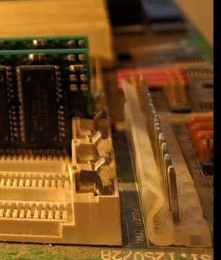

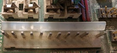

Hi,
Came across an interesting Pentium 60/66 motherboard from '94, which has the power connector slightly different than what I encountered until now.
Photos attached.
53.28 KiB
205 views
28.22 KiB
205 views
Is there a specific power source connector/adapter to be used? or the P8/P9 sockets work as well? If the latter, which would be the recommended way to connect, considering the narrow pins the socket has?
Also, socket on motherboard mises one pin (not soldered at all).
Thanks

Reply 2 of 9, by vmr_
Noticed P8/P9 sockets have a second row of narrow holes, matching nicely with the narrow pins...
However, to connect it that way, the P8/P9 would switch position (but keeping black wires in the middle).

Reply 3 of 9, by derSammler
These holes are for releasing the contact springs, not for connecting to anything.
vmr_ wrote:
However, to connect it that way, the P8/P9 woouls switch position (but keeping black ires in the middle).
Don't even try, the pins are not symmetric.
Could you please show a picture of the whole board? If it's branded, the power connector is probably custom.
Reply 4 of 9, by vmr_
thanks derSammler, so it is the usual way to connect P8/P9.
Not tried yet, asking first 😀

Reply 9 of 9, by vmr_
MMaximus wrote:
I've encountered the same problem a while ago:
XT mobo in AT case: questions about PSU connectors
Thanks Mmaximus, this helps. Good intro for my next system on the list - an XT one
On using the AT P8/P9 on the XT-like power socket, it is my understanding the little fins (keys) on P8/P9 face the S-like plastic part of the XT socket.
So for my first photo, P8 is actually on the right, and P9 on the left side of XT power socket.
