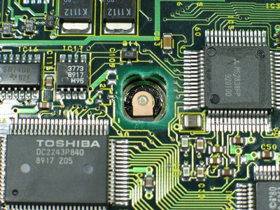

Reply 6 of 15, by precaud
Well I have never encountered a recommendation to oil the spindle motor bearings of a HDD. But one of the four drives in this batch has a bad track 0 and so is expendable, so I decided to experiment, comparing the spin noise before and after putting a small drop of synthetic oil on the bottom of the bearing (see pic).
I have to say, the drive is significantly quieter after the oil.

Reply 7 of 15, by SirNickity
I wasn't referring to the spindle motor, but the stepper motor. (Although... maybe that helps too?) The heads on these drives move like on a floppy drive, and suffer the same kinds of issues. Namely, if they can't move freely, they have trouble seeking accurately. I've seen some videos on YouTube where the heads have been seized from lack of use, and a little oil and some manual persuasion got them moving again.

Reply 10 of 15, by precaud
I did a little test today to satisfy my curiosity. I wanted to see if the lubing and lowering of noise (hence friction) would have any impact on the number of bad sectors it found. I took the above drive that I had lightly oiled the spindle motor, and ran the LLF and post-scan with Speedstor.
And the answer is, nada. No difference.
