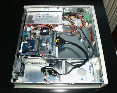

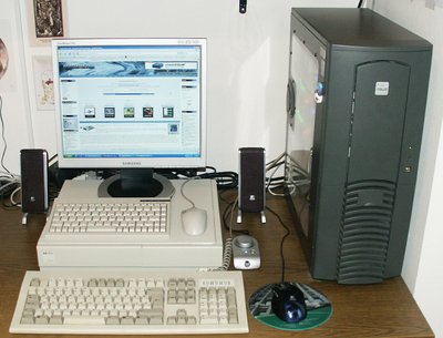

Reply 7 of 7, by Half-Saint
This was my setup back in 2006. I still have the beige pizza box computer, just don't really use it anymore. The grey tower was an AMD socket A system, still ran well at the time but I sold it around 2010-2011 (memory is fuzzy).
