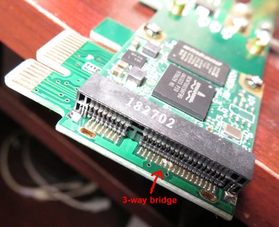

Does your adapter card have these solder bridges on it? I'm wondering if this is why Windows won't detect my CrystalHD decoder card.
Does the back of your mini-PCIe to PCIe adapter card say "PCI-E 1X005"? I presume this is their model number.
If not, I should remove them. Hopefully the Broadcom chip isn't fried because of this. I left the card in a powered-up computer for several days.

EDIT: It's actually only a 2-way bridge. That other element flaked off when I touched it with a probe. Not sure if it was a piece of flake solder or some dirt.
Reply 63 of 94, by Warlord
I only have 1 of those bridges. When I find my phone i'll take a picture. If this is the case it explains things. 6-7 is bridged, 7-8 is a mistake looks like. To be clear the bridge you made an arrow too is the same on my adapter, the bridge to the right of that in your picture I don't have.

The 7-8 bridge looked like a large flat piece of flattened solder. It got knocked off when I touched my multi-meter probes to it. Its not there now. Could this temporary bridge have killed the onboard transistor-looking component on the adapter board?
Reply 66 of 94, by Warlord
looks like you got a bad adapter card, since your card works fine in laptop and we can see discrepancies, in soldering. Hard to know, I feel bad for you but eh, I swear it works you just got unlucky.
Reply 67 of 94, by feipoa
Can you show an image of the back side of your adapter? I want to see if it has the same number written on it as mine.
Seems more likely that my motherboard or BIOS aren't assigning resources to the Broadcom. If that transistor tests good, then what else on the adapter could be bad? Not much there.

Ok. So we have the same adapter card. Both have a solder bridge. Not sure why it doesn’t work in my opteron 185
Reply 71 of 94, by feipoa
I have a second computer that has one PCIe x16 slot, it's an Asus P5GL-MX w/P4 3.8 GHz (Pentium 4 670). This computer properly detects the Broadcom chip. So for whatever reason, the computer I want to actually use this accelerator on, won't work with it. ASRock 939Dual-SATA2 w/FX-60 doesn't detect the Broadcom chip. So I'm going to leave the Broadcom chip in my Lenovo T61 laptop Core2 Duo 2.6 GHz (T7800). Is the T7800 too fast to have any tangible benefit from the CrystalHD accelerator?

I already tried this. The AsRock Opteron 185/FX60 board uses a USB 3.0 w/gigabit ethernet in the PCIe x1 slot normally. The PCIe x16 slot is empty because I'm using AGP for graphics. I tried the CrystalHD in the PCIe x16 and it isn't detected. I moved the USB 3.0/gigabit card to the PCIe x16 slot and it works fine in that slot. I tried the CrystalHD in the PCIe x1 slot, and it is not detected.
